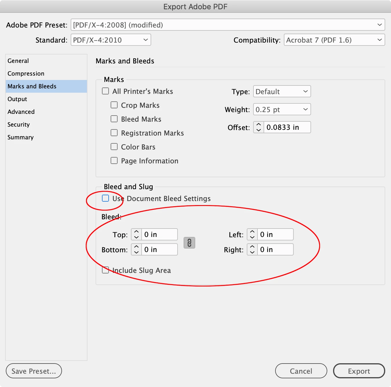

Hi @RK2020mm , When you Export a PDF you set the Bleeds in the Marks and Bleeds tab—uncheck Use Document Bleed Settings and set the Bleeds to 0:
For an existing PDF you can set the bleeds in AcrobatPro via Print Production>Set Page Boxes
