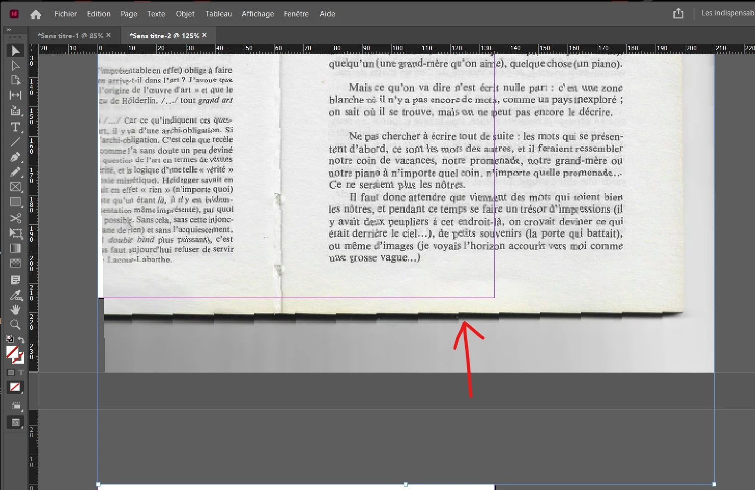

I have made a scan to PDF in acrobat pro.
Then in InDesign I have used the function Script / "Place multipage page PDF".
But here is the result in InDesign : you can see at the bottom a display problem (like a staircase) :
If I change the display quality in InDesign (from standard to superior), this display problem is always here.
If I see the same PDF in Acrobat Pro, there is no display problem.
How to remove this display problem inside InDesign ?

Are you absolutely sure that the pictures are displayed in “qualité supérieure”? This display problem may also occur if the image is rescaled in InDesign.  In your case, I think that it has been scaled down. What percentage do you read? But anyway, the only thing that matters is the final PDF that you will output from this indesign file. If it is OK in the PDF, no reason to worry.

But inside InDesign, this display problem gives me some problems to crop with the mouse around the PDF : this display like a staircase prevent me to select the crop limit around the PDF with the mouse very precisely.

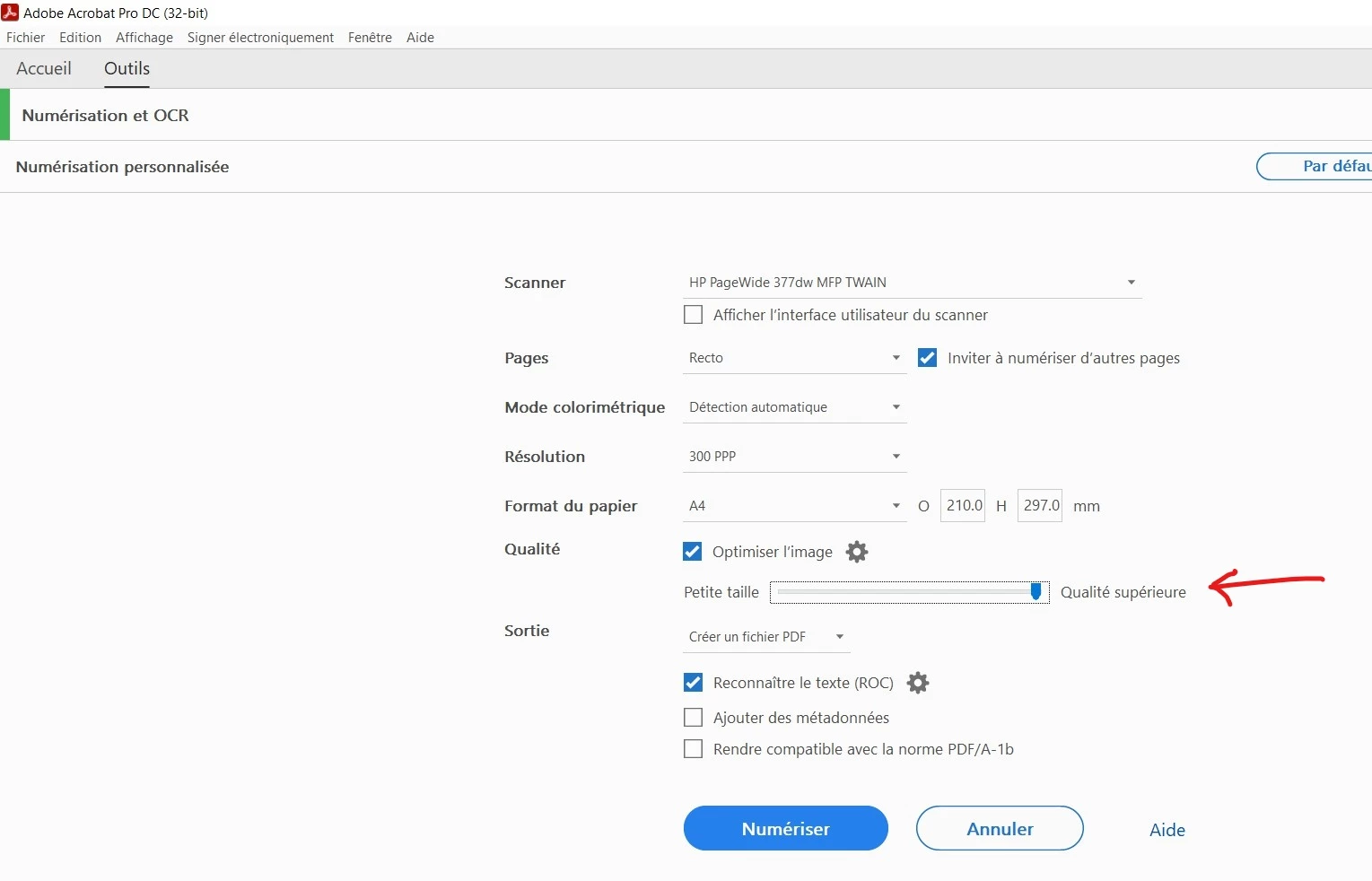

About what I see in acrobat pro scan settings, I was with 300 ppp and max quality. And the PDF was imported in InDesign as it was created in Acrobat. In Acrobat Pro scan settings the compression had been also unchecked.

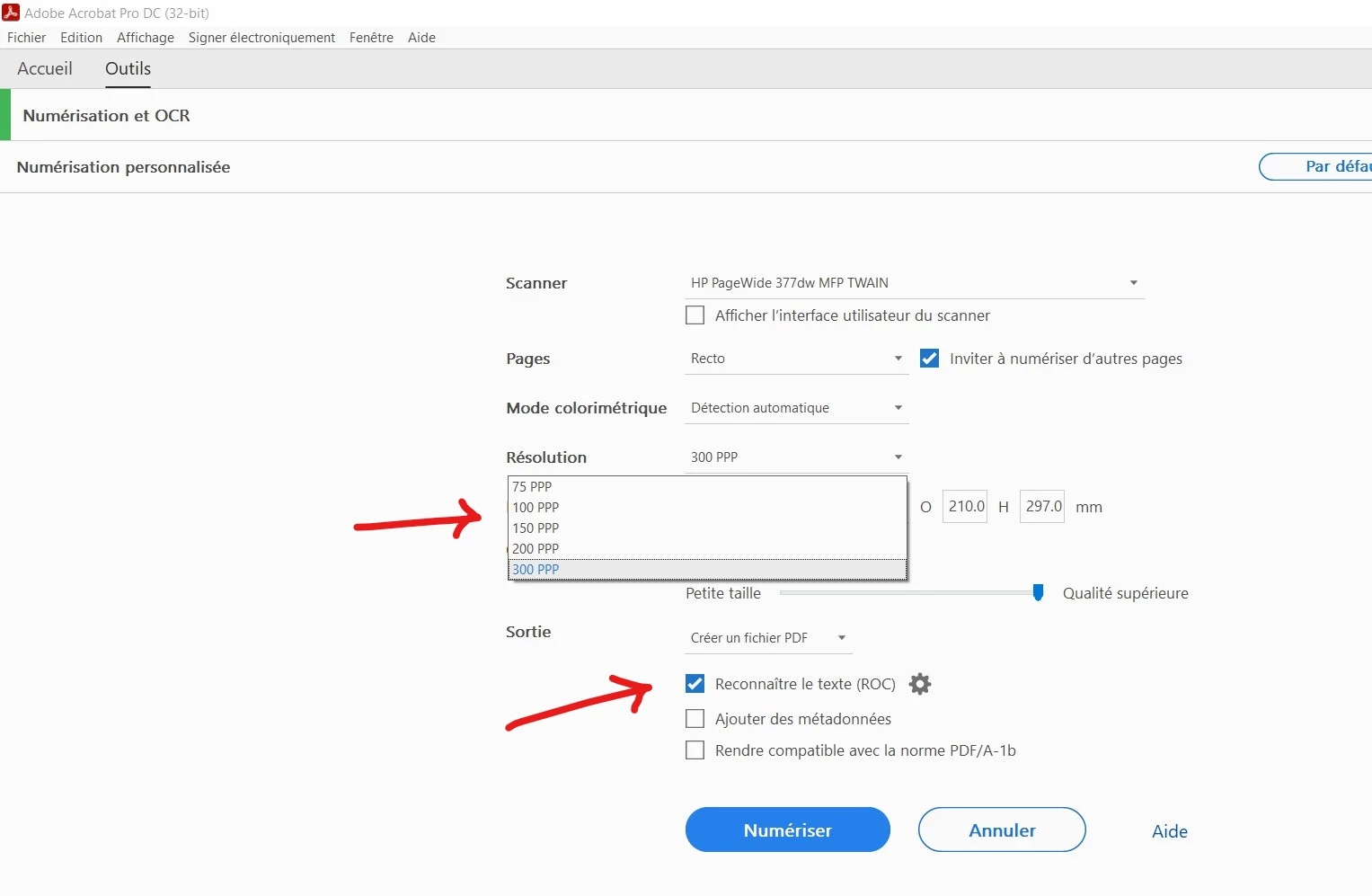

About scanner device resolution, if I go in Acrobat Pro scan settings I can see that I have a maximum of 300 ppp :
For the created PDF that I use inside InDesign, I was on 300 ppp.
As you can see, I was also with OCR checked.
According to what you have said, I have made a test by unchecking OCR and making a full scan (4 pages).
The result : in Indesign, the problem has gone, but some pages are not rotated and I have pages with some skewed pages, so I am obliged to rotate and change the angle, but by doing that, the problems appears again ...

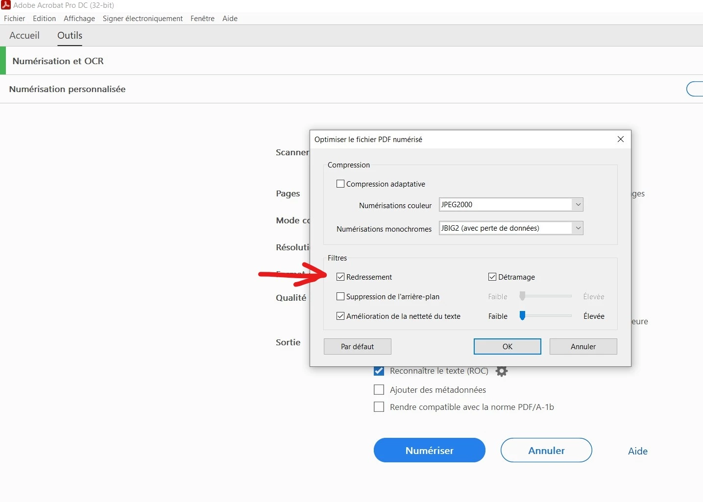

1) For this PDF inside InDesign, I have not made a rotation of the PDF. And you can see here that the PDF was created in Acrobat Pro by checking the option "image straightening" :
2) If I try to change the scan quality inside Acrobat Pro (to superior quality), and if I import this new PDF in InDesign, I have the same display problem in InDesign.
Here is the selection of scan quality inside Acrobat Pro :
