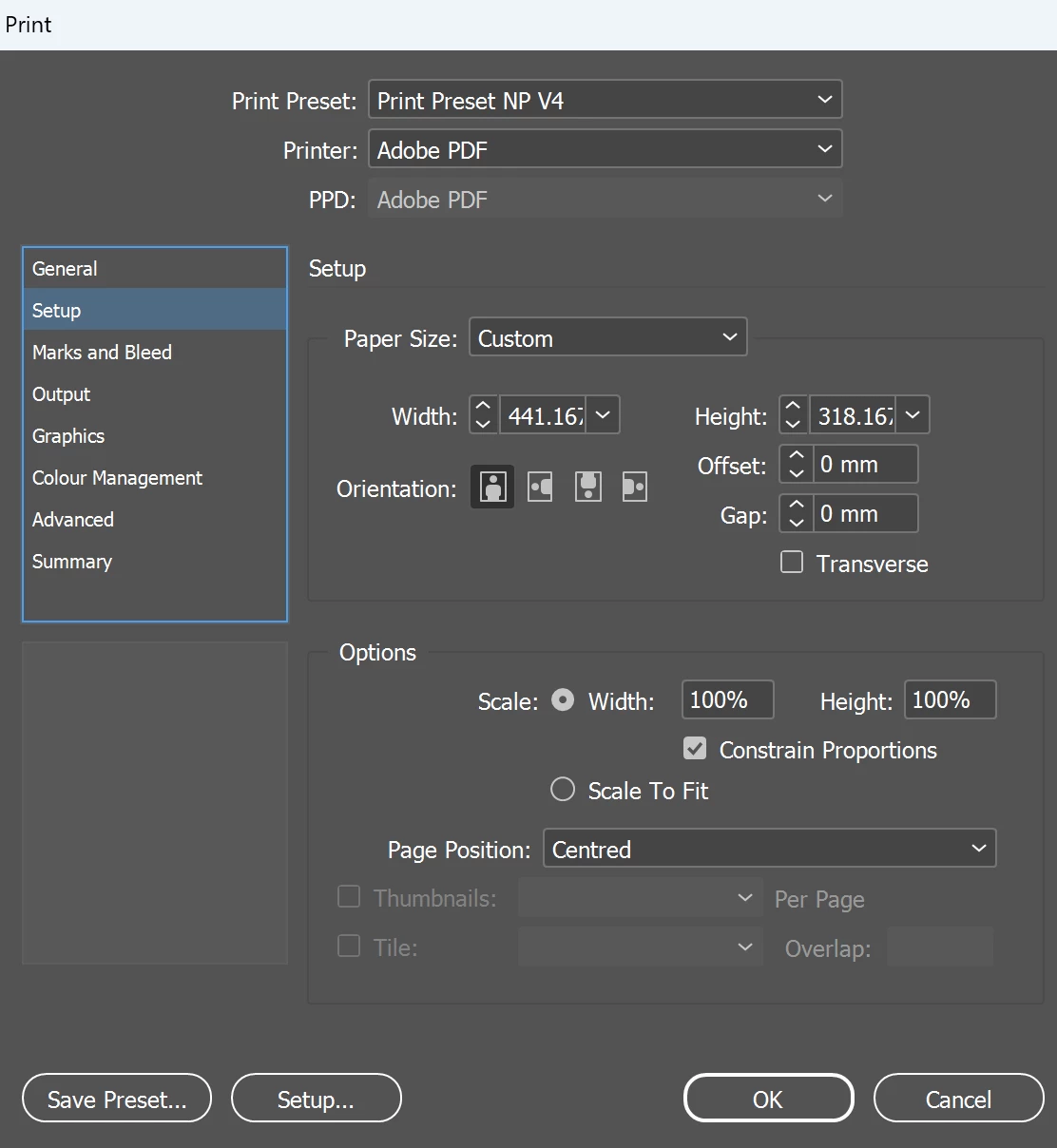

The only thing I saw on your screen captures is the paper size set to Custom. Usually, the paper size automatcially adjusts as needed. and the width/height are in parentheses. (Number in parentheses are InDesign's method of showing auto settings.)
Your page number are not in parentheses. Try resetting the custom setting.

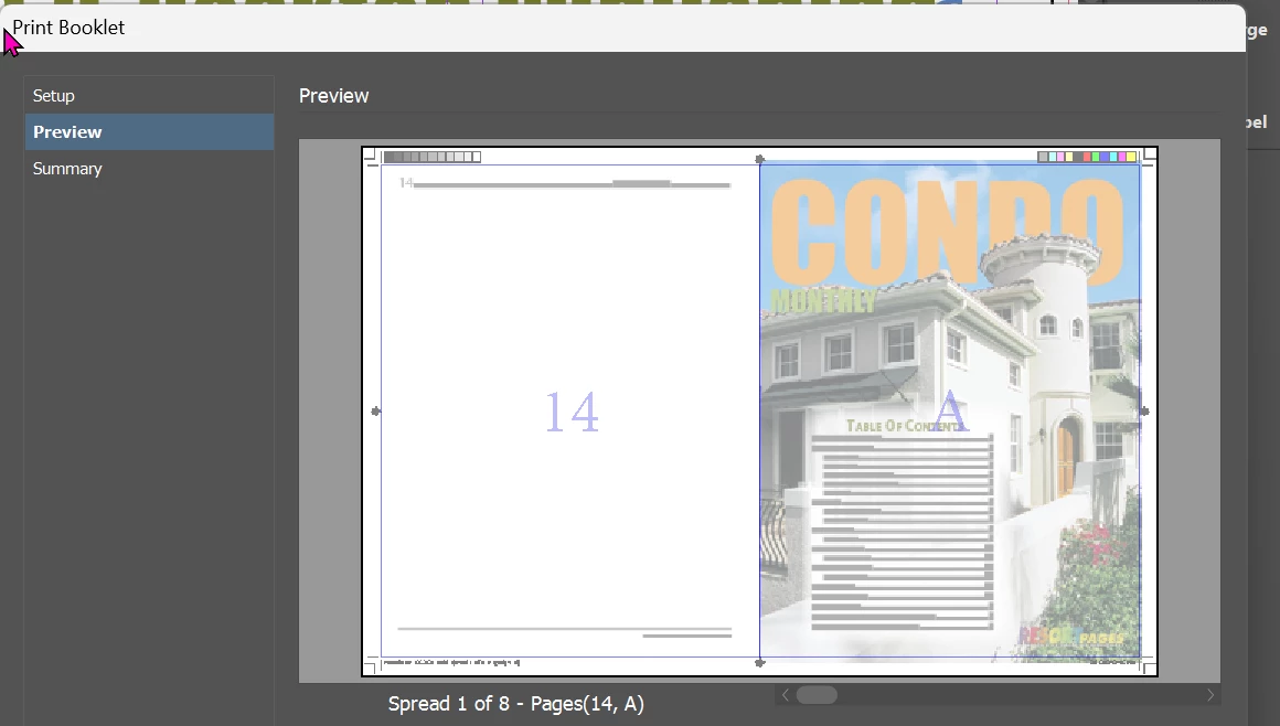

Also, can you show a copy of your booklet preview?
