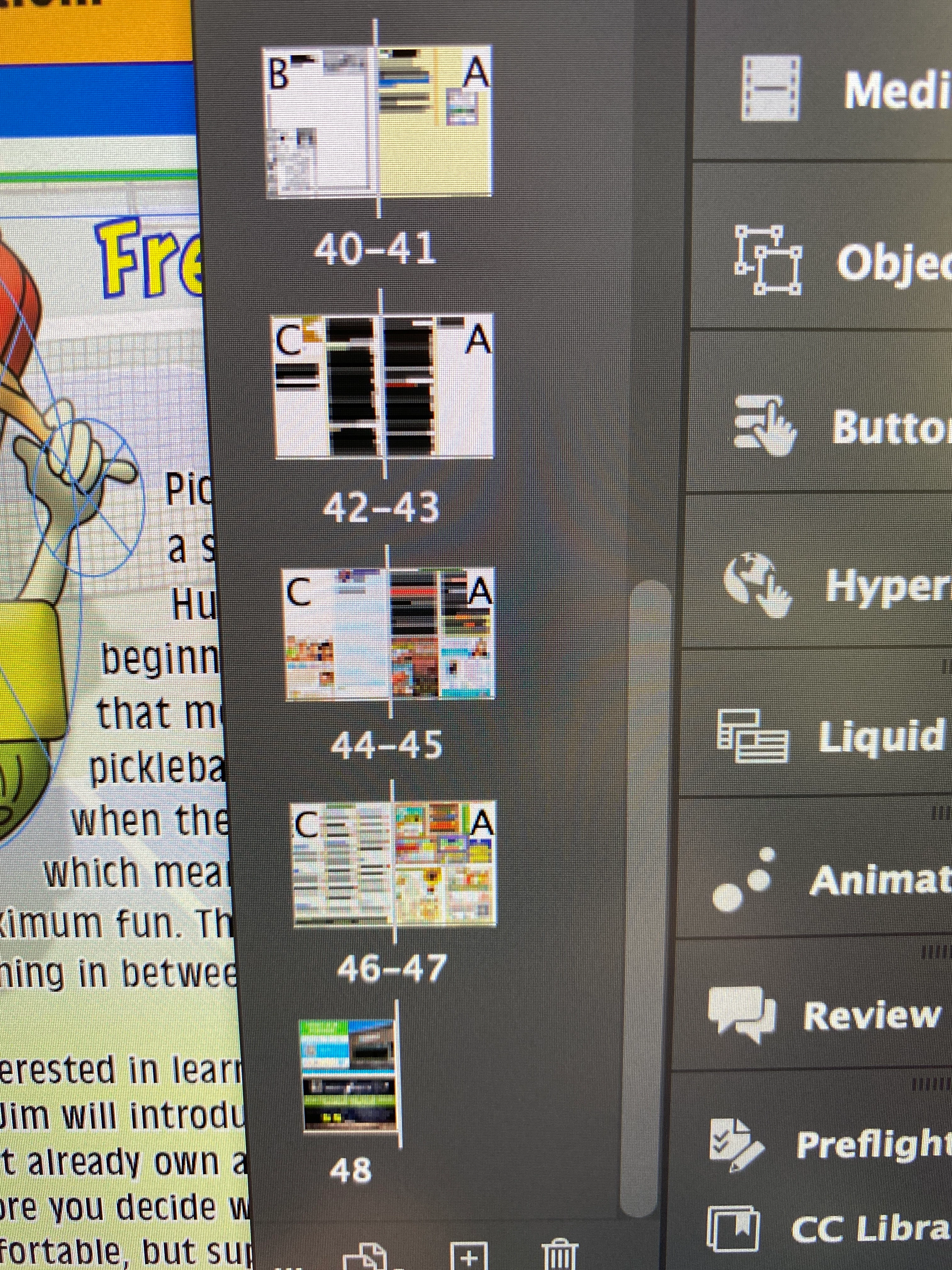

My exported pdf file for an InDesign document with a set bleed is showing the first two page spread incorrectly. The bleed from the right facing page is showing on the blank page and appears to be much larger than the actual bleed size indicated/selected. I have tried exporting a couple of different ways and the problem persists. Help!

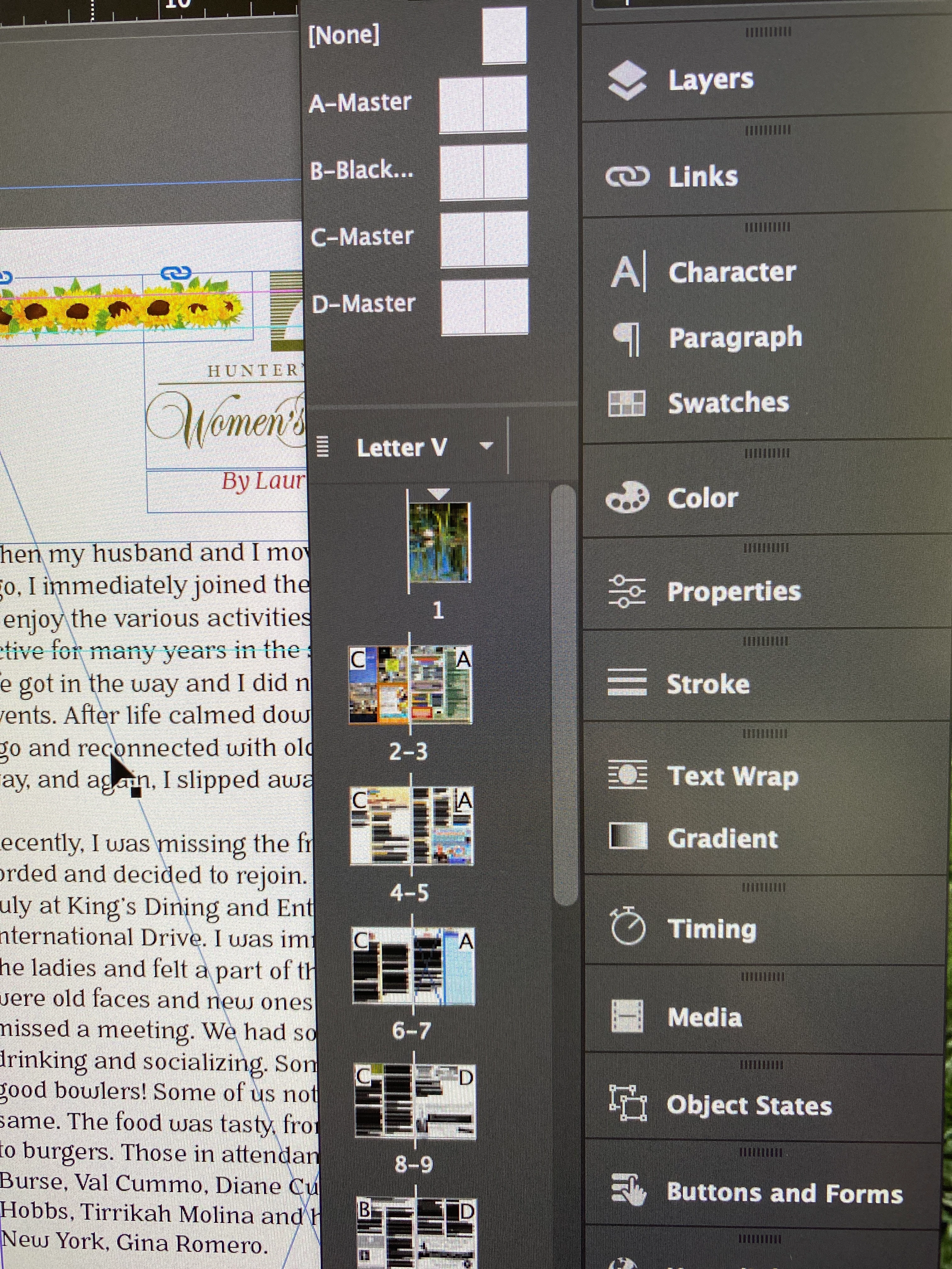

    Are your pages set up like this?
     The first page should be alone on the right side. The last page she be alone on the left side.
