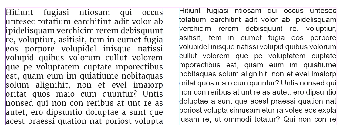

It's quite a 'large' font - here it is alongside Arial 12pt
As you can see 12pt Merriwehter font alongside another font at 12pt is quite large.
For a printed piece I wouldn't use 12pt for any body text.
