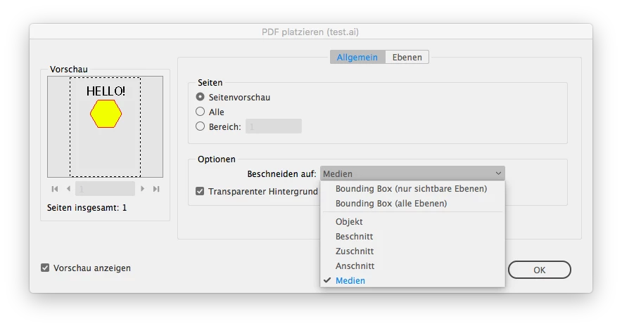

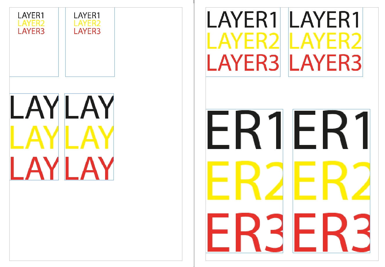

Ive made a little test:
I have an illustrator-file showing 3 lines of text, also I made a copy of this file.
What you see on the first forum-image, are 4 test-images (left) and the corresponding image linked to the copy of my illu-file (right).
On the left page I used the method "medium" and the image-box shows the page A4 as bounds. I also made a zoom on the file as test, below.

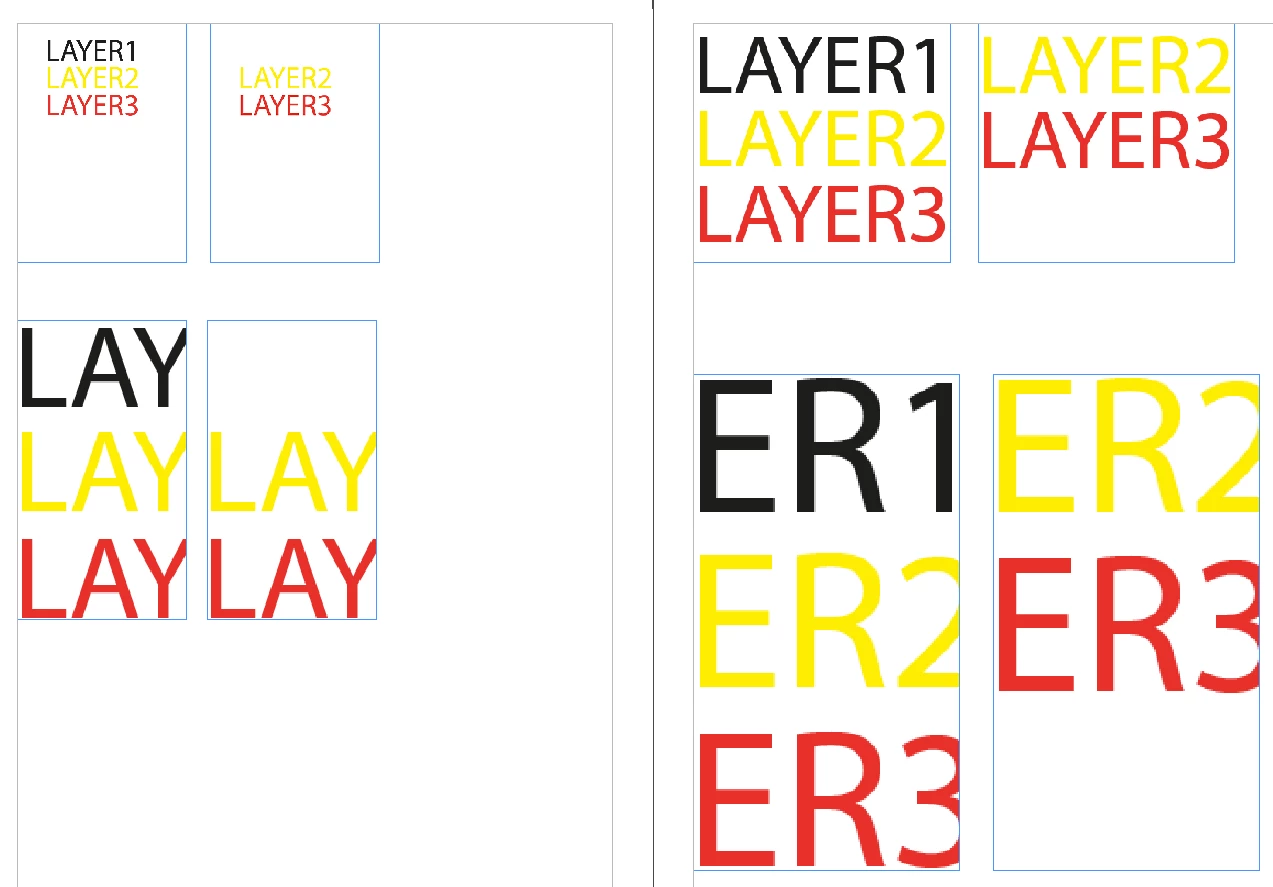

On the second forum-image:
Ive deleted text 'layer 1' in the copy of my AI, refreshed the links (the ones on the right side), and see what happens:
While I used the method with the medium as bounds, the positioning within the indesign image container doesnt change.
But if you place imported as 'object', moving object around in AI results in new boundaries, e.g. x/y=0/0 is "layer 1", now 0/0 is 'layer 2'. While placed as a page/medium (doesnt have a englsih client) the 'layer2'-pos doesnt change x/y=34,271/48,818 mm.
As you see, its key to know how you imported your ai.
