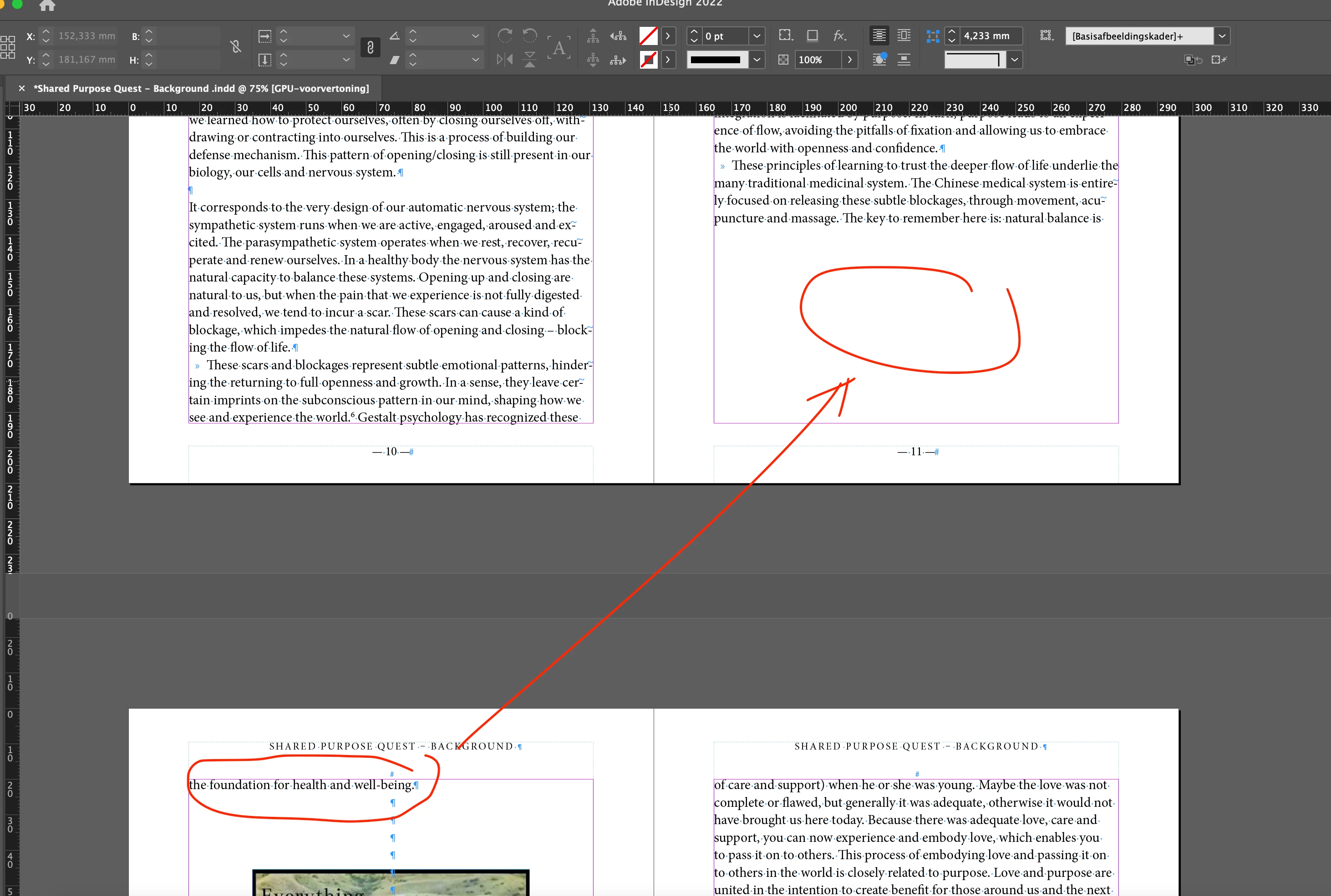

I have a book with text pages. The last line of one paragraph is being pushed to the next page, whatever I do (hard return just before, switch off all 'keep options'.
How?
See screenshot.
Thanks!

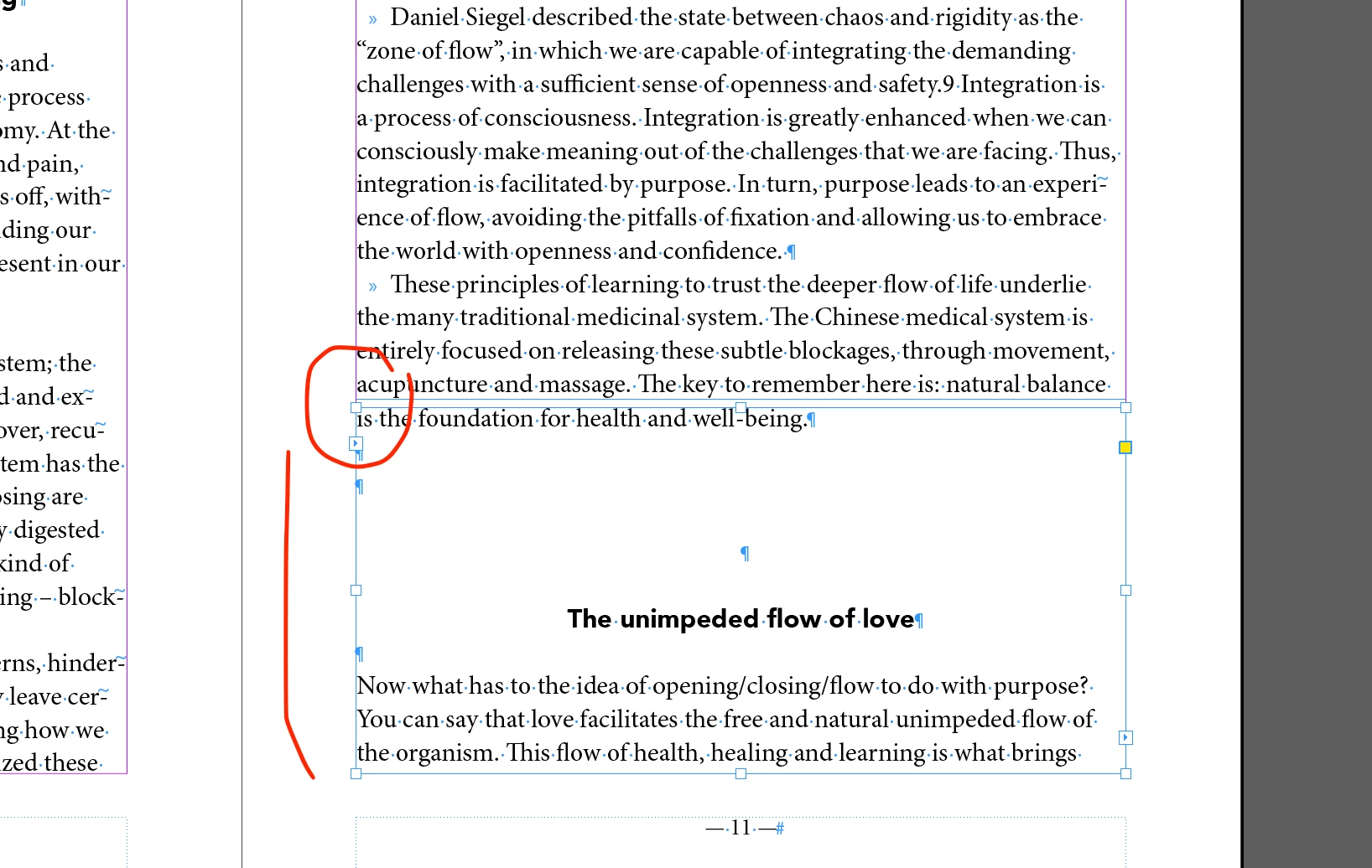

Could page 11 secretly have an empty no stroke/ no fill frame/box/object  in the lower part of that page? Maybe it is an object on the master page. If there is an invisible frame object, maybe that object has Text Wrap turned on?
Mike Witherell
August 25, 2022
My thought, but no.
Solved it like this for now: shortened the text frame, created another text frame underneath and let the text flow on.

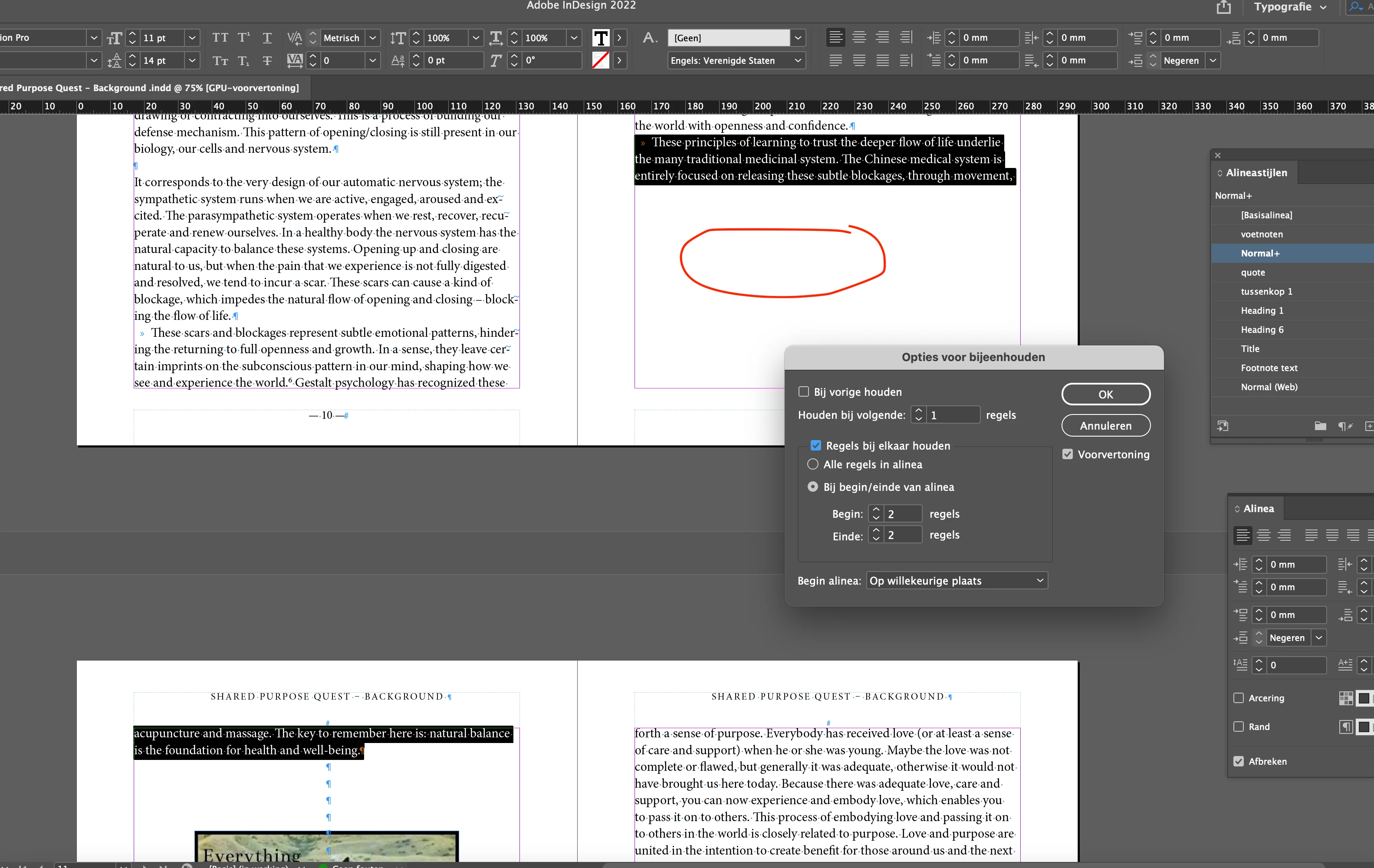

Do you have Keep With Next set in the Keep Options menu? Uncheck that. As Mike notes, there are many options to control text flow in this panel and your solution (and eventual satisfaction with the text breaks) probably lies there.
Brad @ Roaring Mouse
August 25, 2022
Your screen grab shows Keep With Next set at 1.
This will definitely cause your issue if all those extra returns also have the same setting; it's trying to keep them all together and consequently pulling your single line from the previous page.
Instead, Set it to 0
(This is NOT controlled by the checkbox immediately above (Keep With Previous); these are two separate settings).
But yes, as advised, you should not be using paragraph returns for spacing; causes no end of issues. The more you use Paragraphs Styles, with all the spacing and tab options available, the more it will make sense to you, and you will soon never go back to what I call "typewriter spacing".
