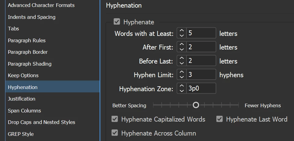

Laying out a book where I'm finding a surprisingly high rate of first lines to paragraphs hyphenating. Approximately half the first lines to some chapters. The line length is a fairly standard 12–15 words, though usually a word shorter on the first line as it's indented (by .55cm), but this seems to be having the effect of dramatically increasing the instances of hyphenation on that first line. It interrupts flow when when it happens so consistently, just as the reader is trying to gain momentum on that first line. Any thoughts? Appreciate all replies.

There may be some technical reasons (style setting) that is causing this, but I'd bet it's just the way the chips are falling with your content.
Tweak your hyphenation settings by a tick here and there to see if you can push ID to distribute the breaks a little more evenly.

Certainly a possibility that this is an expression of sheer randomness, and many adjustments to H&J settings were tried with some success, but overall, it's a compromise if I opt to eliminate these hyphenations on the first line. Does it bother others as much if you see 80% of the first couple pages' paragraphs hyphenating on the first line?
