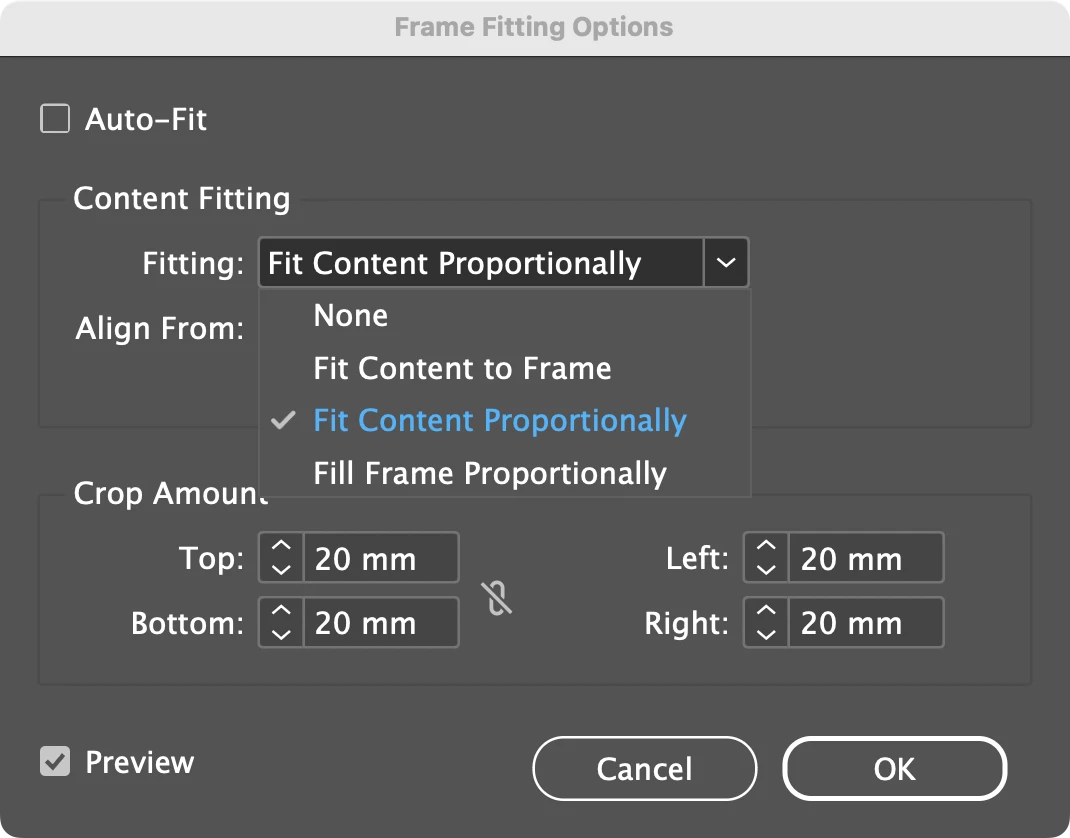

I'm doing a data merge that links in images.  The feature I'm looking for used to just be the default setting in indesign but several versions ago it stopped working for me and my peers.
I set up my template page that is the layout I want for each record. Some linked images I change the fitting on so that it's a zoomed(viewfound) in to only a portion of the linked file.  Then in my data merge panel when I hit "create merged document" the document ignores the fitting I have put on my linked images and resets all to just fit proportionally in their frames.
I've tried poking at the fitting settings in the data merge panel with no success.  I've tried making an object style with fitting settings and also had no success.
This used to just automatically happen and now for the life of me I can't find a repeatable method for this to just work like it used to.  Attaching a screen shot for visual reference.  Can anyone help me figure out how to make those fittings stick for the merge?

    You say it used to work, but I've never gotten it to work the way you describe. When an image is placed via Data Merge, there is some form of "reaction" to its size and proportions. Are all the images you're merging the same size and aspect ratio?
    October 17, 2019
    Yes they would all be the same. I have new info. It appears I was mis-remembering how it had been working and it in fact wasn't resizing things during the merge. Instead things were going in full size as is what we are seeing. I'm going to mark this as answered since it was my fault I was remembering it incorrectly. Thank you for your reply!

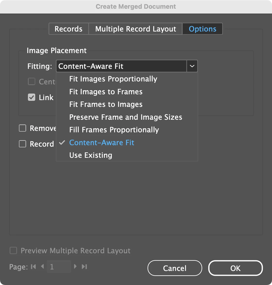

    For some reason Data Merge ignores some of the Obejct Frame Fitting options.
    But Data Merge also has its own options for Image Fitting under the options tab.
    And there is more of them which I wish were also under the Obejct Frame Fitting options?
