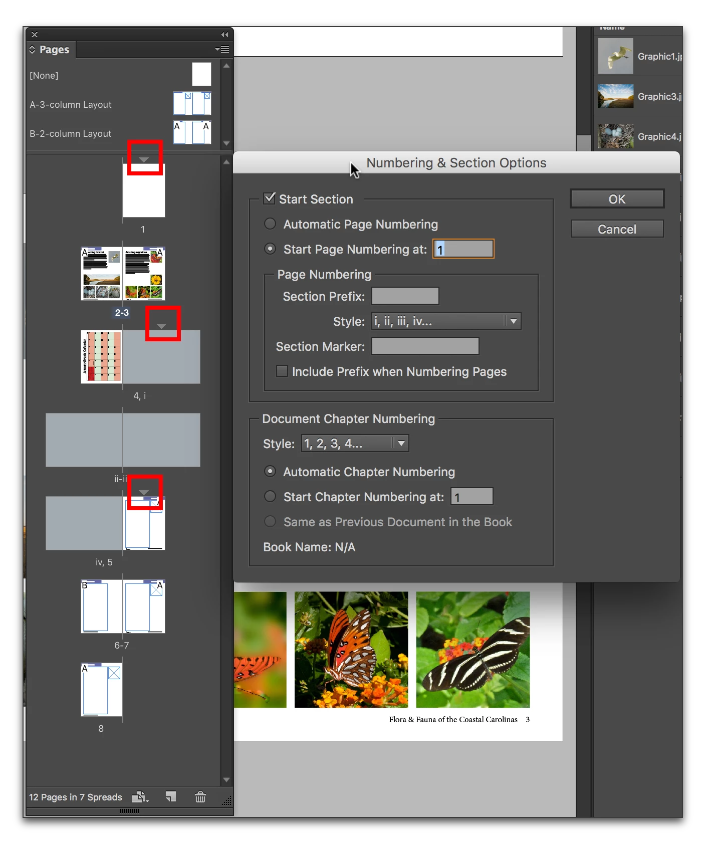

And to add to that, InDesign uses a tiny (oft-unnoticed) visual aid to help you see what is happening with the page numbers. Each time you change the numbering—skipping, changing the style, etc.—InDesign puts a little triangle above the page icon in the Pages panel. If you click it once, it highlights the section that Will ^^ is referring to. If you double click it, you can update the numbering and section options. When page numbering gets wacky (because perhaps you inherited someone else's document) recognizing the role of the triangles helps you immediately straighten it out.
In my screen shot below, pages i–iv are highlighted because I clicked the triangle over page i. The panel is open because I then double clicked it.
