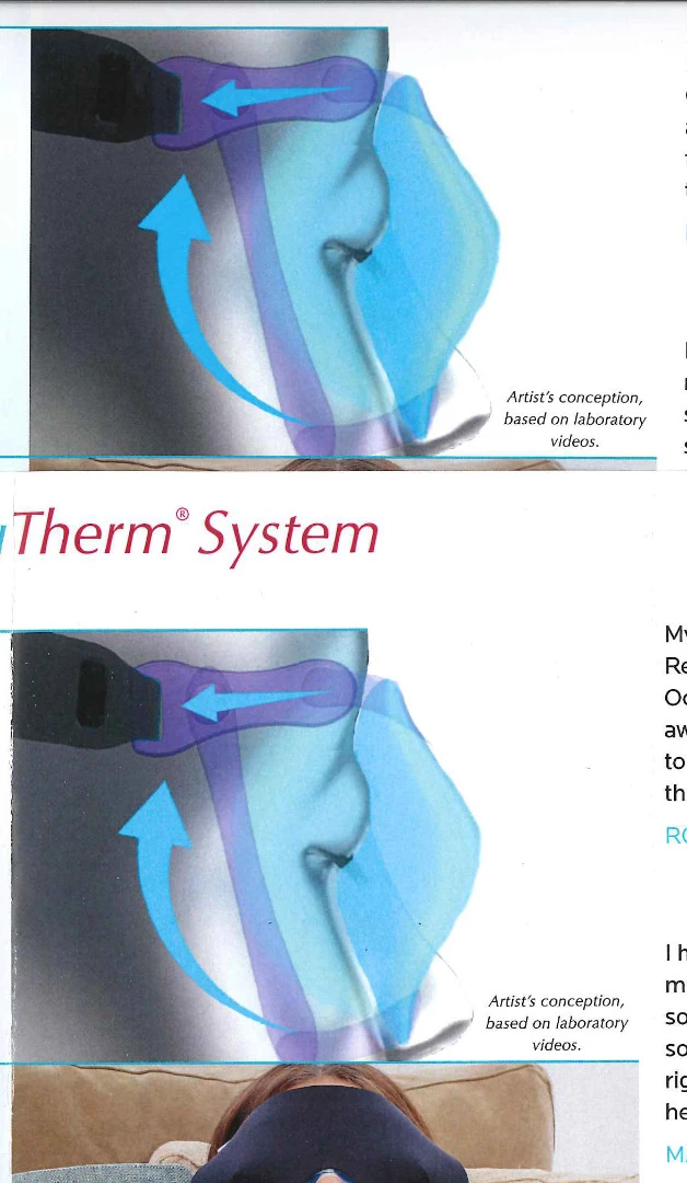

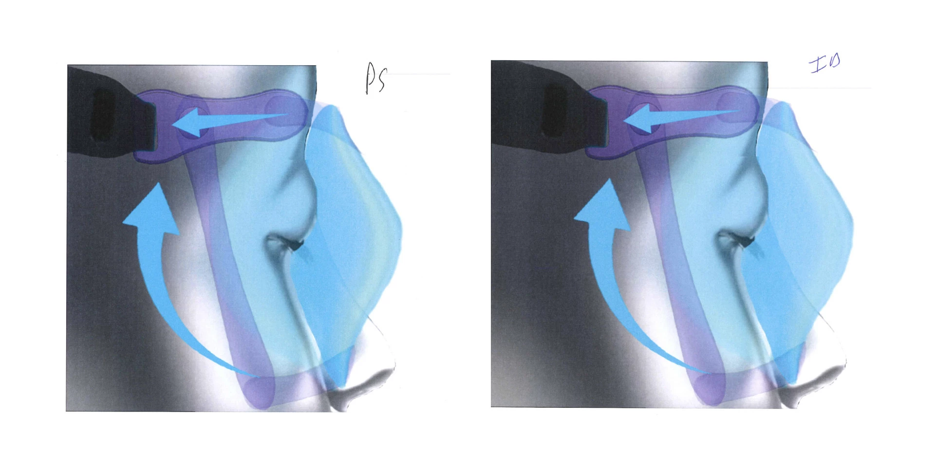

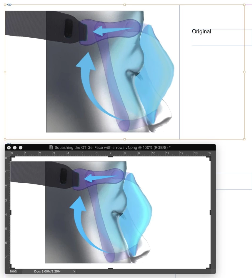

I have an RGB PNG of a product. In Photoshop, the image looks vibrant (bottom screen shot in Attachment_1). When I place into ID, the colors are very muted (top screen shot in Attachment_1) and print that way. I believe ID automatically creates CMYK preview/conversion. The reason I think this is that when I converted to CMYK in PS it looked identical to the placed RGB file in ID. Additionally, when I print directly from PS the image prints better but still isn't vibrant (Attachment_2). It's critical that the cyan glow on the right in image is very apparent in the printed piece. Any advice appreciated on getting the photo to print better from ID or exported PDF out of ID.
Correct answer rob day
But that wouldn’t fix the RGB out-of-gamut problem. If the document is going to be printed you would want to turn on Overprint Preview, which will preview the RGB color in the CMYK space.

  1. When you have images from Photoshop save them as PSD and not as PNG and place the PSD directly.
  2. The RGB mode is much wider than the CMYK mode.
  3. If you have to print anything you will always end up with a CMYK at the printed product, so you cannot expect vibrant Colors anyway.

I changed transparency blend space to RGB and it displayed properly. Printed better as well but the cyan glow isn't prominent at all.

The top photo is printing with transparency blend set to RGB in ID a few moments ago.
Steve Werner
December 15, 2018
The PNG file probably was saved as transparent PNG.
Placing transparency of any kind will force all of the colors into the current blend color space. Look at Edit > Transparency Blend Space and it's probably Document CMYK.
