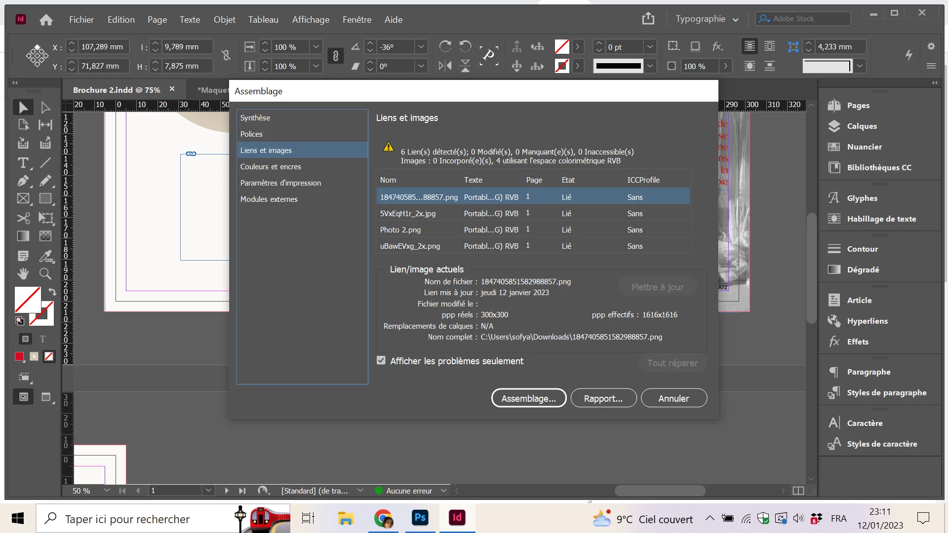

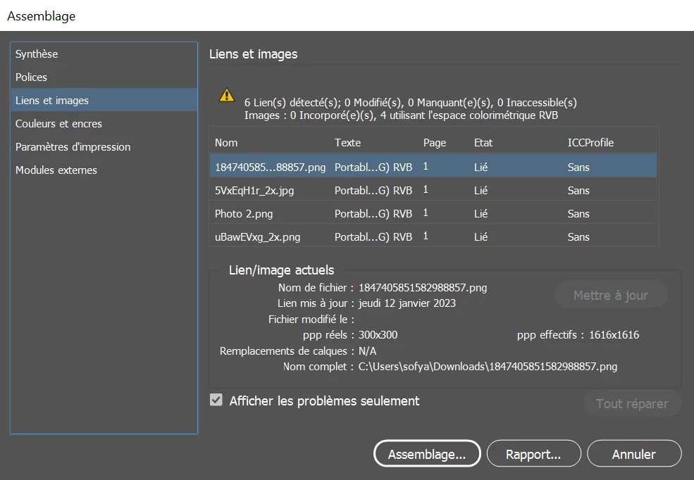

I am currently working on a resume on InDesign, and I set all the settings so it can be printed in CMYK.
However, it says that some of the pictures I've used are still in RGB. I don't understand, as I put the pictures in Photoshop before to convert them in CMYK, and when I check, everything says that the picture is in CMYK (as you can see on the pictures I've attached)
Do you know how I could resolve that?
Btw, my InDesign is in French on the pictures so I'm sorry about that (CMJN = CMYK and RVB = RGB)
Thanks for your advice!

You mention this is a resume, but that you are printing in CMYK. I suspect the number of copies you need is far too small to run on a printing press, so mostlikely this is going to be printed digitally, either on your own printer or by a printing service.
While digital printers/copiers that are fed from a RIP, which you might find in a copy shop, accept CMYK data natively, desktop printers and non-RIP-driven printers do not, so you would probably be better off keeping the images in RGB (which is the current recommended workflow, even for press output). If conversion to CMYK needs to happen it is usually best to let it be done at the RIP so colors can be matched using the correct provile for the specific print condition. As Jean Marc says this can also be done during export, but unless the printer has provided the correct profile and instructions to do the conversion, you are better off saving as something like PDF/X-4 which preserves the color information and let the printer do the conversion at print time.

Hi @Nelsya , When you use Export or the legacy Save for Web to save your PNG’s they are converted to RGB even when the Image>Mode is CMYK.

If you want proper CMYK - you need to save your images as PSD - with appropriate profile attached - TIFF is also OK but PSD is much better.
PNG definitely doesn't support CMYK - only RGB.
