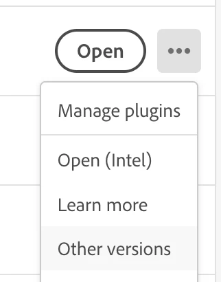

If other suggestions don't help:
InDesign 18.4 introduced numerous PDF export problems which may or may not be related to your issue. Some of them - but not all - were fixed in 18.5. Try to roll back to InDesign 18.3 (you can do it from the Creative Cloud app). You'll need to install InDesign 2023 first if you don't have it anymore.
If you don't have any issues with 18.3 then you can report your problem as a bug to Adobe.
