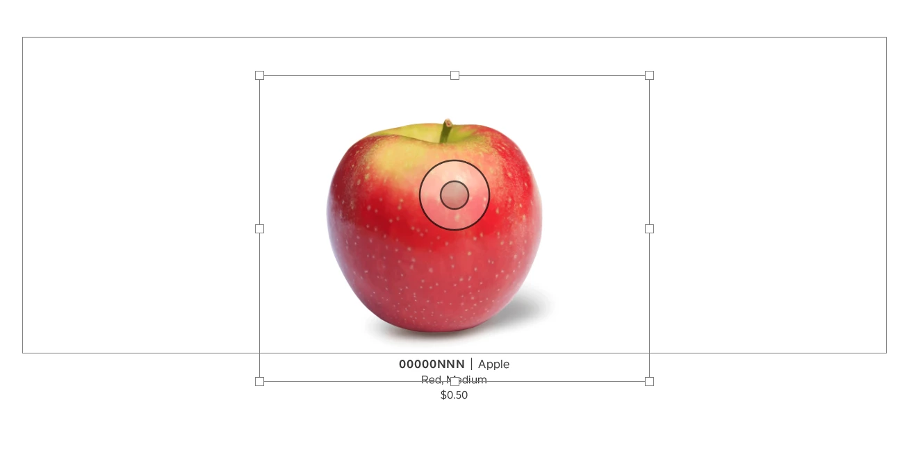

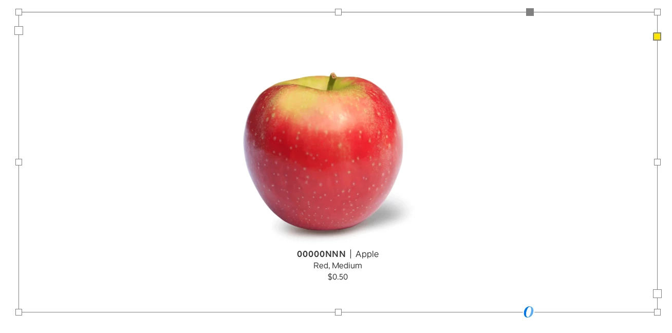

Hi All,

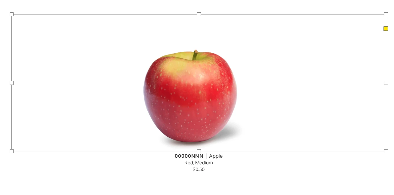

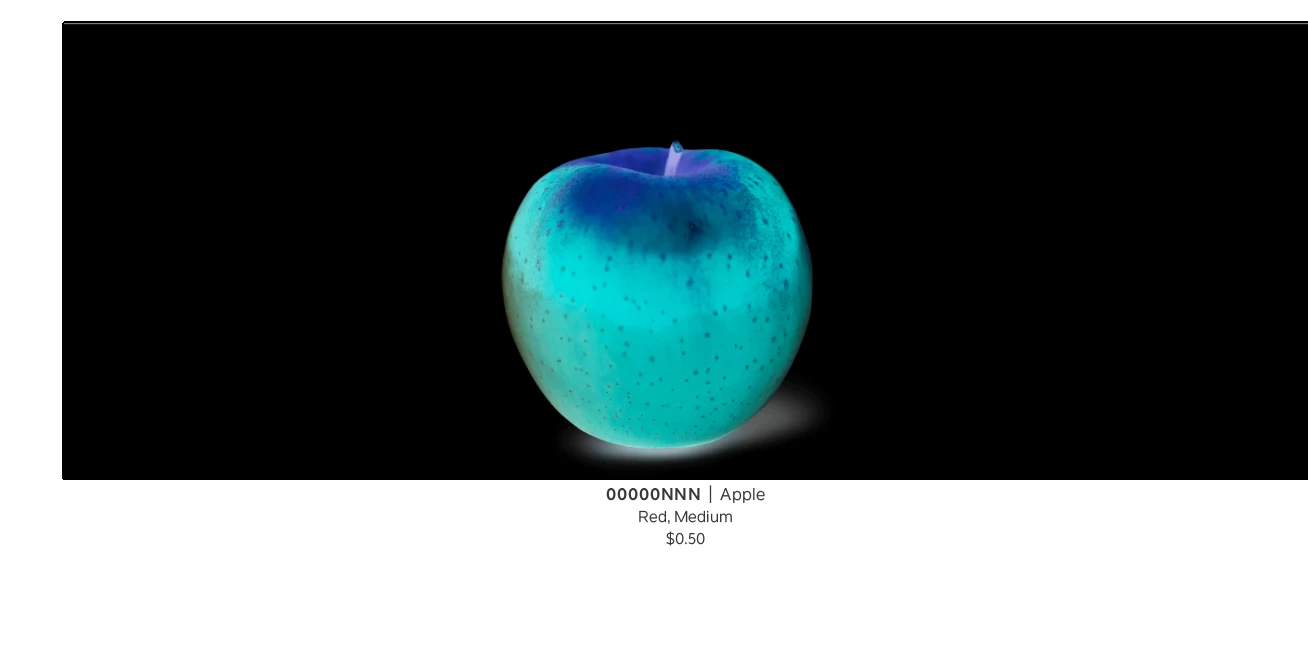

I have a multi-page document that has been in-line data merged. Each frame contains a table with 2 rows -- an image on top and text on the bottom (Image 1). I wrote a script that will find/select the text and apply an object style to that box. However, I can't seem to figure out how to script finding and selecting the larger image frame on the top to apply an object style to that box (Image 2). The 3rd and 4th image areas won't work with my object style, so those areas can't be selected. Any suggestions? Each page has 5-9 boxes, like the sample below, and I don't want to manually select each image frame to apply the object style.
