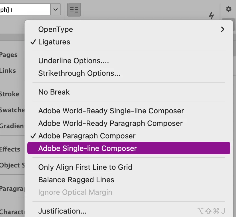

The default Adobe Paragraph Composer purposely tries to recompose lines to produce the best spacing for the type.
If you want only individual lines to be affected during composition, choose Adobe Single-Line Composer from the Control Panel menu:

Thank you for your reply. If I select the Single-line Composer, will it protect the whole document?
I am going into the office to work on the project and I will try your suggestion.
I will let you know and thanks again.
Steve Werner
February 10, 2024
The Composer is a document-wide setting so it should apply to all lines in the document.
