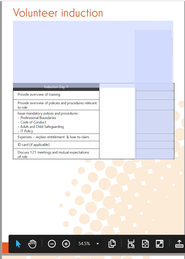

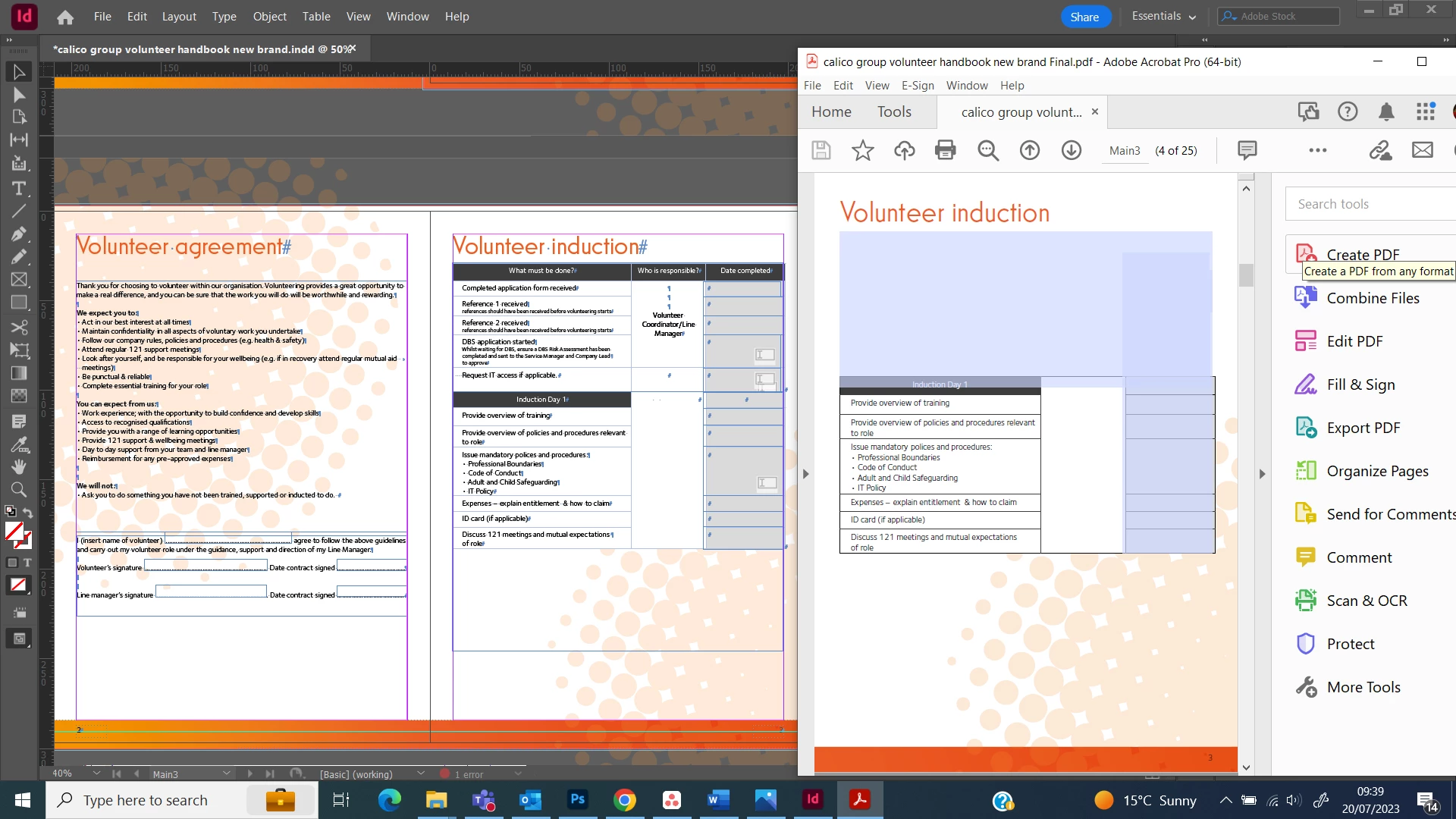

Hello.
I have a document that contains multiple tables to fill in.
Almost all tables exported successfully accept one. The text-filling field is there, but the table and its content are just a blank, white space. I did export successfully before, but when I return to the project to make a few amends today, the table doesn't export.

Is it on a layer that is designated non-printing?
~Barb
July 13, 2023
No, all layers have selected that they are print layers.
Steve Werner
July 13, 2023
You might save the file as an IDML to remove corruption in the file. Choose File > Save As > InDesign CS4 or Later [IDML]). Then re-open the file in InDesign to see if you get different results.
July 13, 2023
Thank you for your advice, but unfortunately, this didn't help. The table is present I InDesign, but disappears in .pdf
