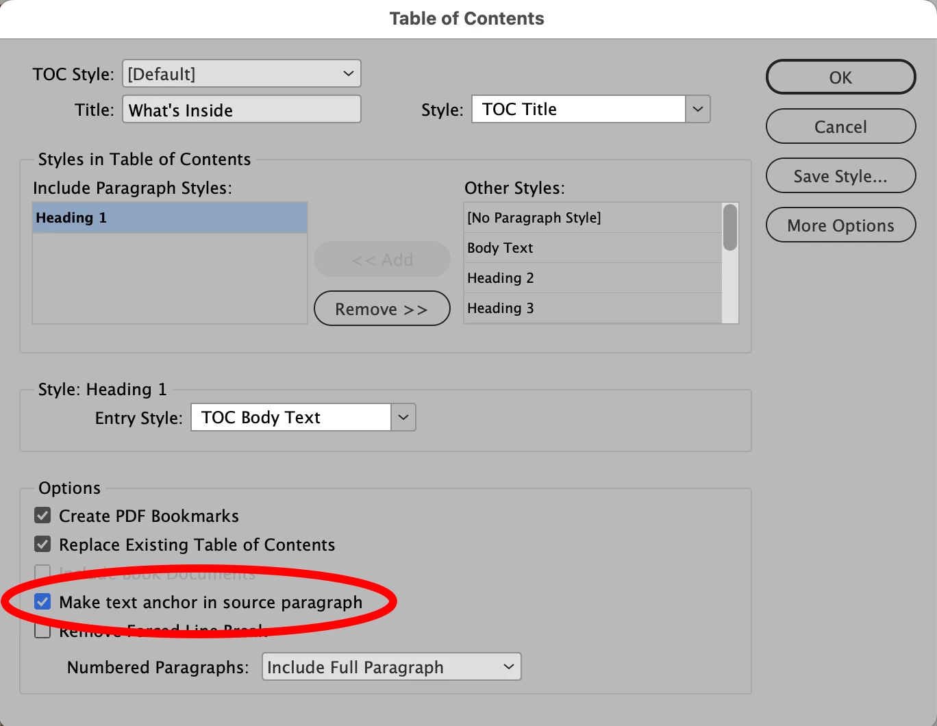

I created a PDF of a book and everything went smothly but the links in the TOC all point to the cover. I found a similar thread on this, but the solution was to reinstall ID 15. I am on ID 18.1 for Mac now. Any ideas on what I can do about this?
Best, Boris

    Willi's suggestions are good. The one you may not be familiar with is circled below—"Make text anchor in source paragraph" must be checked.

    Thank you Willi and Steve for your promt and helpful reactions. Yes, you are so right Steve, I did not know that tickbox. It works like a charme. Thank you for making my day!
    All the best,
    Boris

    Did setup the anchor on target paragraph in the toc setting?
    Did you activate links in PDF export?
    Which PDF viewer do you use?
