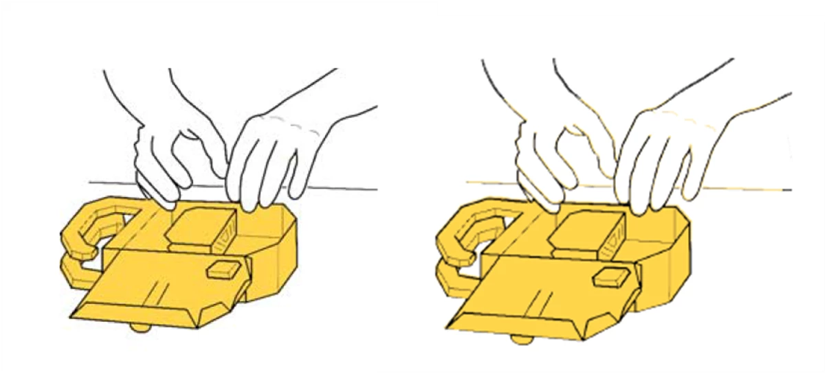

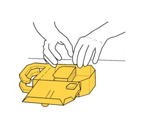

I have an image that I created (original.png) below. It is 1165 x 900. This was saved from photoshop with a 300 dpi. Please notice it looks fairly clean and high quality:
I placed this image InDesign. The problems arise when I try to create a PDF.  (Please note all high quality settings were used for creating these PDFs, like I checked my downsampling to be a minimum of 300 (and I've tried no downsampling) and high quality print option is used, etc).

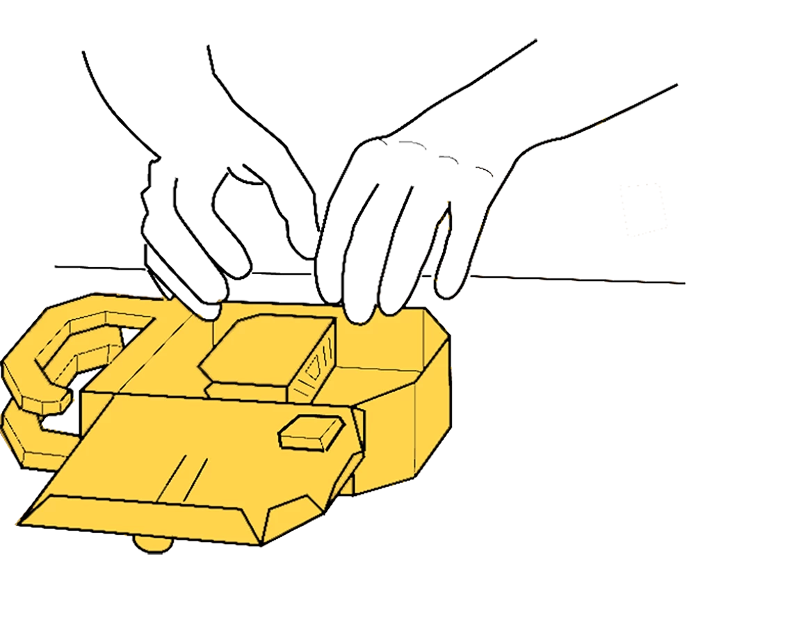

When I use the PRINT> Adobe Print method to create the pdf, I get this (below). Please notice the degradation of quality PLUS artifacting (if you look closely).---BUT it gets even worse...
When I try to use the EXPORT option to create a PDF (Adobe PDF (print) or (interactive)), I get terrible results (below):
Would anyone please help me to correct this, so my PDF quality will be better?  Thank you.

ok, so I tried a few suggestions here...
I used the PSD file in InDesign, instead of a png from PSD, and I bumped up my settings to 600 for max ppi threshold.  But it's still not looking good.  Below, is the orginal image and the exported PDF (using PSD file in indesign):

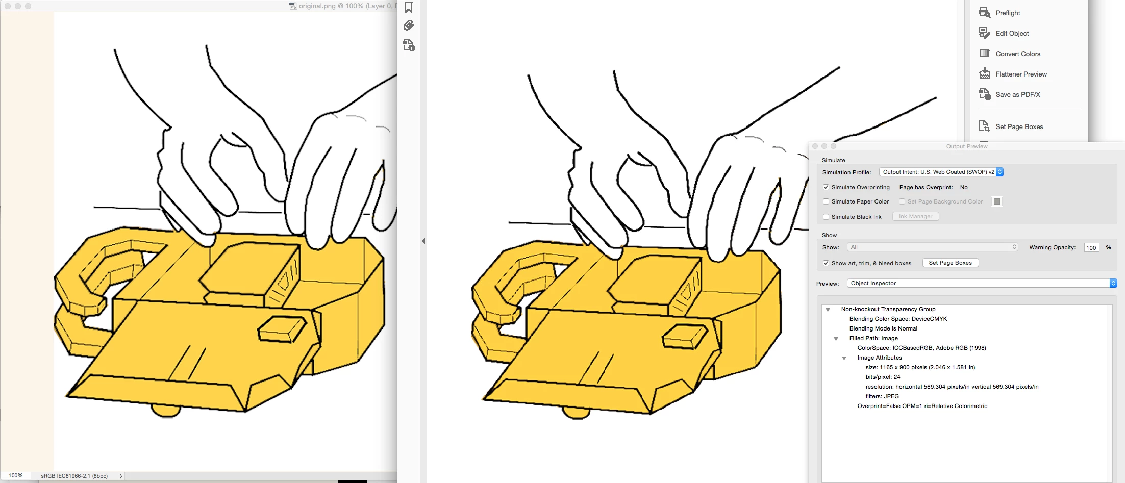

rob day
September 20, 2017
You can check whether the image has changed using AcrobatPro's Output Preview>Object Inspector. Using your original scaled 50%, with the threshold set to 600ppi, I don't see a problem. Object Inspector tells me the pixel dimension is unchanged at 1165x900:
One thing you have to consider is how the PDF reader application anti-aliases the preview as you zoom in and out. Photoshop and Acrobat use different definitions for the 100% view. I think what you are seeing is the affect of zooming on line art.

So I did original do the line art in Illustrator, but dropped in the yellow in photoshop.
The problem is more evident with the original and exported poor quality side by side and same size.:

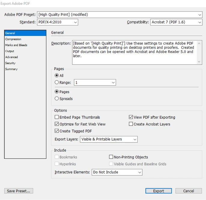

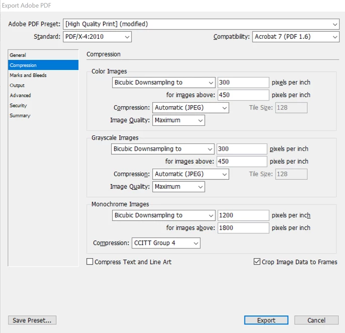

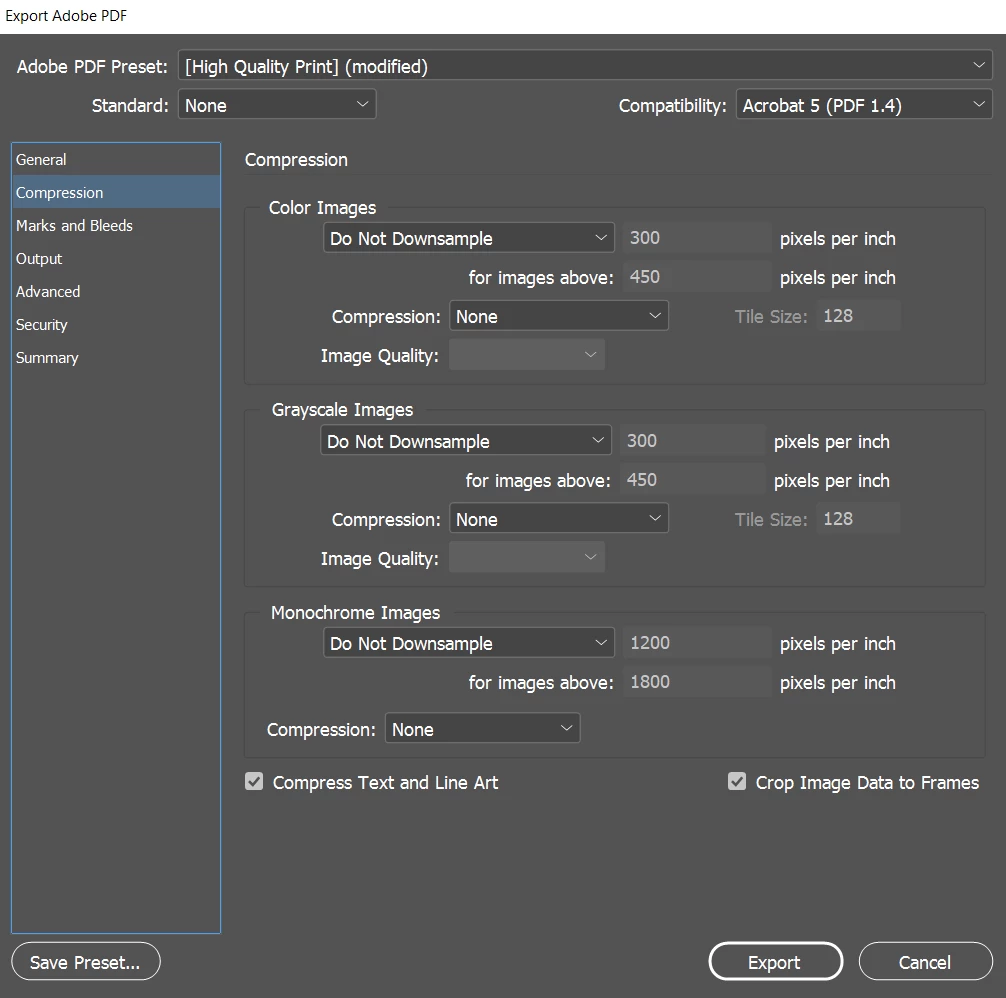

Here are my export settings (I also tried no downsampling):

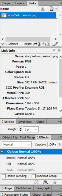

The effective PPI is 567:
Any ideas? Thanks!!
rob day
September 20, 2017
Your effective ppi is above the 450ppi threshold you've set in the Compression tab so the png is going to be downsampled nearly in half to 300ppi.
Also the original you posted in #1 looks like it has been upsampled from some lower resolution.

The artefacts happen when the PDF settings use a 'jpeg' compression.
Can yo add a couple of screen shots to show the settings you used when exporting to pdf? so we can give you the best feedback possible.
