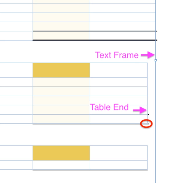

Hello
I imported some tables from Word into Indesign and created some cell styles and some of them seem to be spilling over from where the table should end. Any ideas on how to make them stop where the table ends?
Thanks
Wai

April 14, 2023
That's not the issue- made text frame go to the end of the table too
April 14, 2023
I was able to duplicate this by adding a wide white stroke on the right side of the table, and setting the stroke drawing order to Row Strokes in Front
