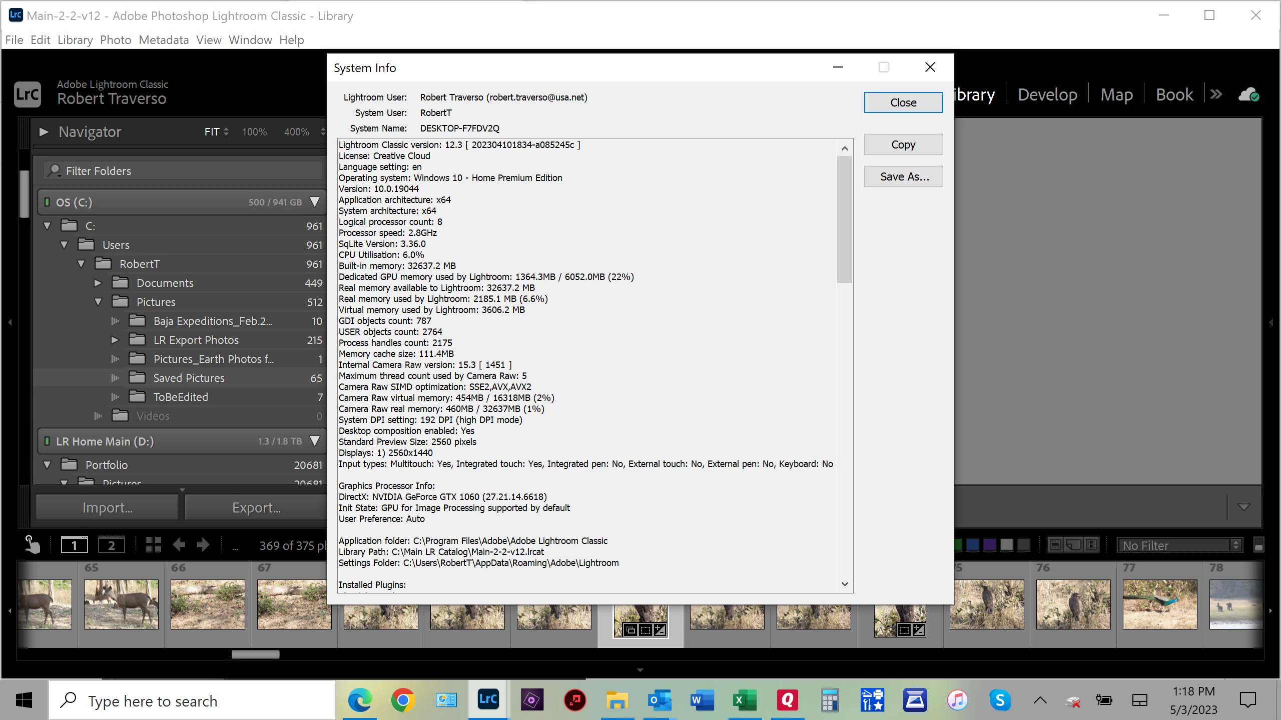

It would also be helpful if you could post a copy of your 'System Info'. This can be obtained from the LrC Help > System Info menu item as shown in attached screenshot.

May 3, 2023
Here is the requested LR Classic screenshot.
