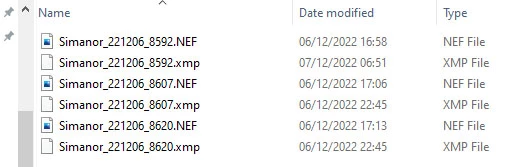

I have checked that both files and xmp's are present in the folder and that their denomination is correct (see attached screenshot)

You will need the previous catalog to have written all the editing you want out to XMP before the new catalog can read them in from XMP. If this had happened for some images, and not for others, only those some would reflect prior edits.
You can tell LrC to later re-read external XMP: Library module / Metadata menu / command 'Read Metadata from File'. Thus you could go back to the old Catalog, highlight those images, write metadata out (Ctrl+S), go to the new Catalog, read metadata in.
