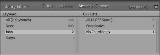

An alternate method is to use the Library Filter bar:

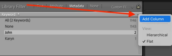

First, add the Keyword column by hovering over the right end of the desired keyword and clicking the right-arrow that magically appears:
Then click the menu at the end of the Keyword column to add a new column:

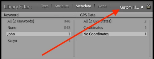

Change the second column to GPS Data:
Finally, click Custom Filter and do Save Current Settings As New Preset:
This has some advantages over smart collections:
- Smart collections can't match keywords exactly (without lots of extra effort), so you can get spurious extra photos in your results, especially with larger numbers of keywords.
- The filter is restricted to the current folder or collection (or All Photographs), whereas it's tedious to restrict a smart collection to a folder or collection (and matching folder/collection names is not exact, just like with keywords).
- With filters, you control whether you see matching photos inside of stacks by doing Photo > Stacking > Expand/Collapse All Stacks.  Smart collections don't provide that control -- they always show results in collapsed stacks.

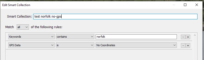

You can make a Smart Collection. This will begin with just one inclusion rule, but by clicking (+) you can add more.
Also you can select that to appear in this Smart Collection, an image must simultaneously meet ALL these rules - otherwise, it only needs to meet ANY (= at least one) of the current inclusion rules.
Something like this:
