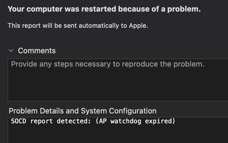

My macbook pro m1Pro keeps crashing and crashes the mac whenever I open the app or when I try exporing images. The export reaches around 80% and crashes. I have more than enough hdd space. I've tried differnet things, but nothing works. Any recommendations?

"SOCD report detected: (AP watchdog expired)"
see:
Possible hard drive issue?
I found that via google, their may be others
And what did the Apple Techs state about that Apple error screen?

There was no clear response, the root cause is still unknown even after full OS reset, deep system analytics. Possible cause is some issues with the logic board, hence, hardware. But then again, the macbook does not crash when using Davinci Resolve and exporting 4k video, but crashes mostly on Lightroom.

The only crash report I get is this one from MacOS. There are no crash reports from Lightroom as it crashes the macbook.
