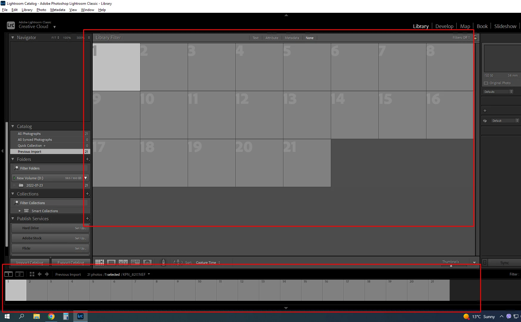

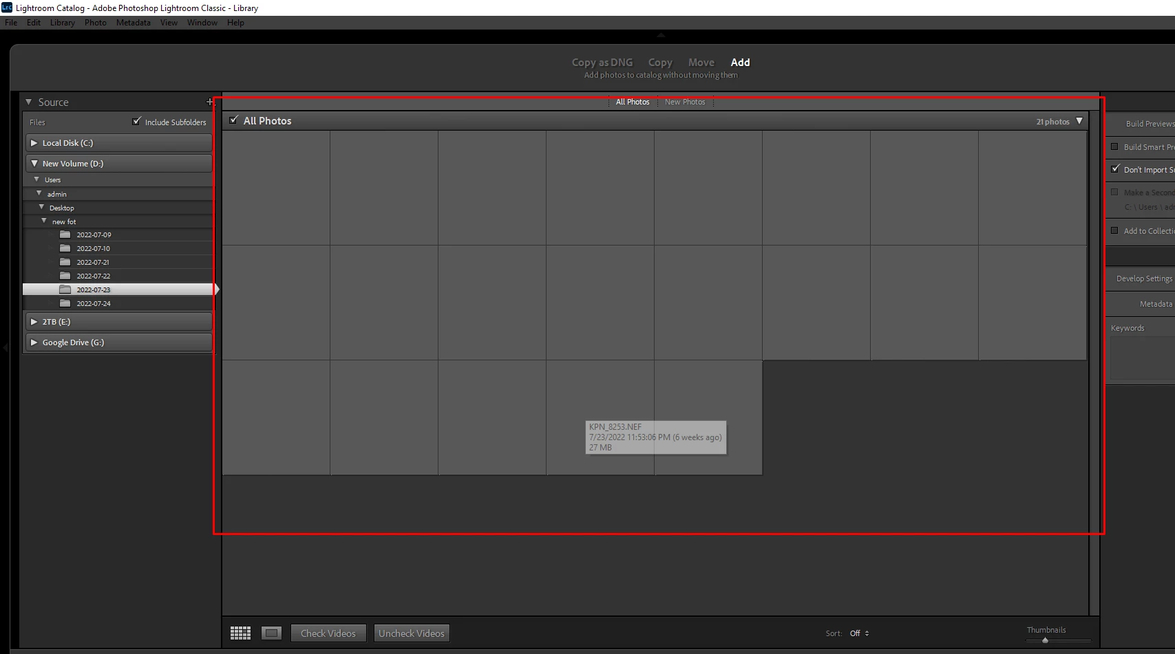

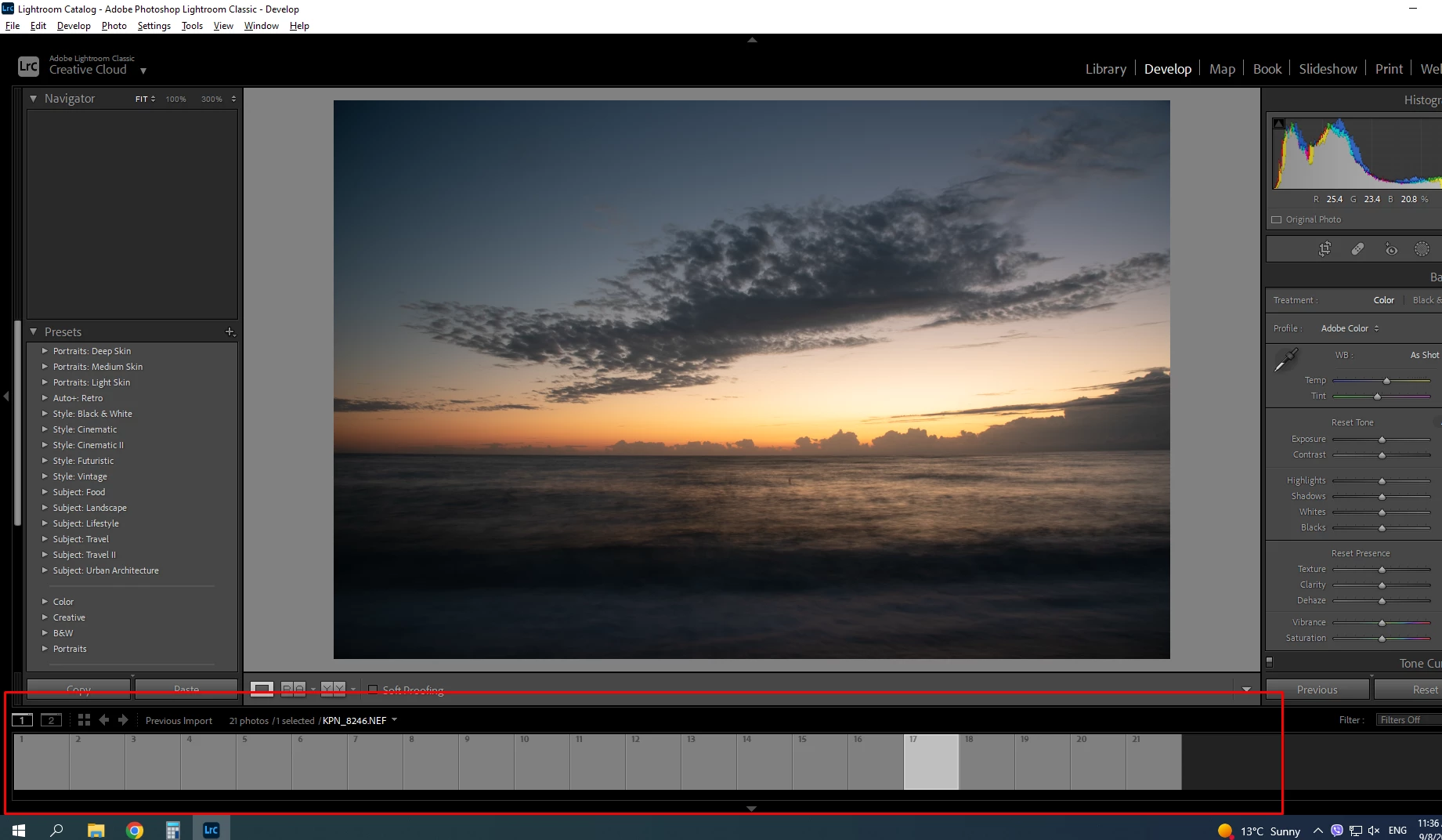

my photoshop lightroom doesn't shows previews during import, imported in the library and botttom previews in develop mode, see screenshots
any ideas ?

Try to disable the GPU. Preferences > Performance > set Use graphics processor to Off.
If this fixes the issue, update for your graphics driver if there's a newer version available, then try to turn the GPU back on.
Another possibility is that you have a defective monitor profile,
Try setting the monitor profile to sRGB (use Adobe RGB if you have a wide gamut monitor). If that fixes the issue, you should ideally calibrate your monitor with a hardware calibrator, which will also create and install a custom monitor profile.
Press the Windows key + R, type colorcpl in the box and press Enter.
Add the sRGB profile, then set it as default.
If neither of these suggestions work, try resetting the preferences.
See https://www.lightroomqueen.com/how-do-i-reset-lightrooms-preferences/

thanks, added sRGB profile and prbolem fixed 😉
