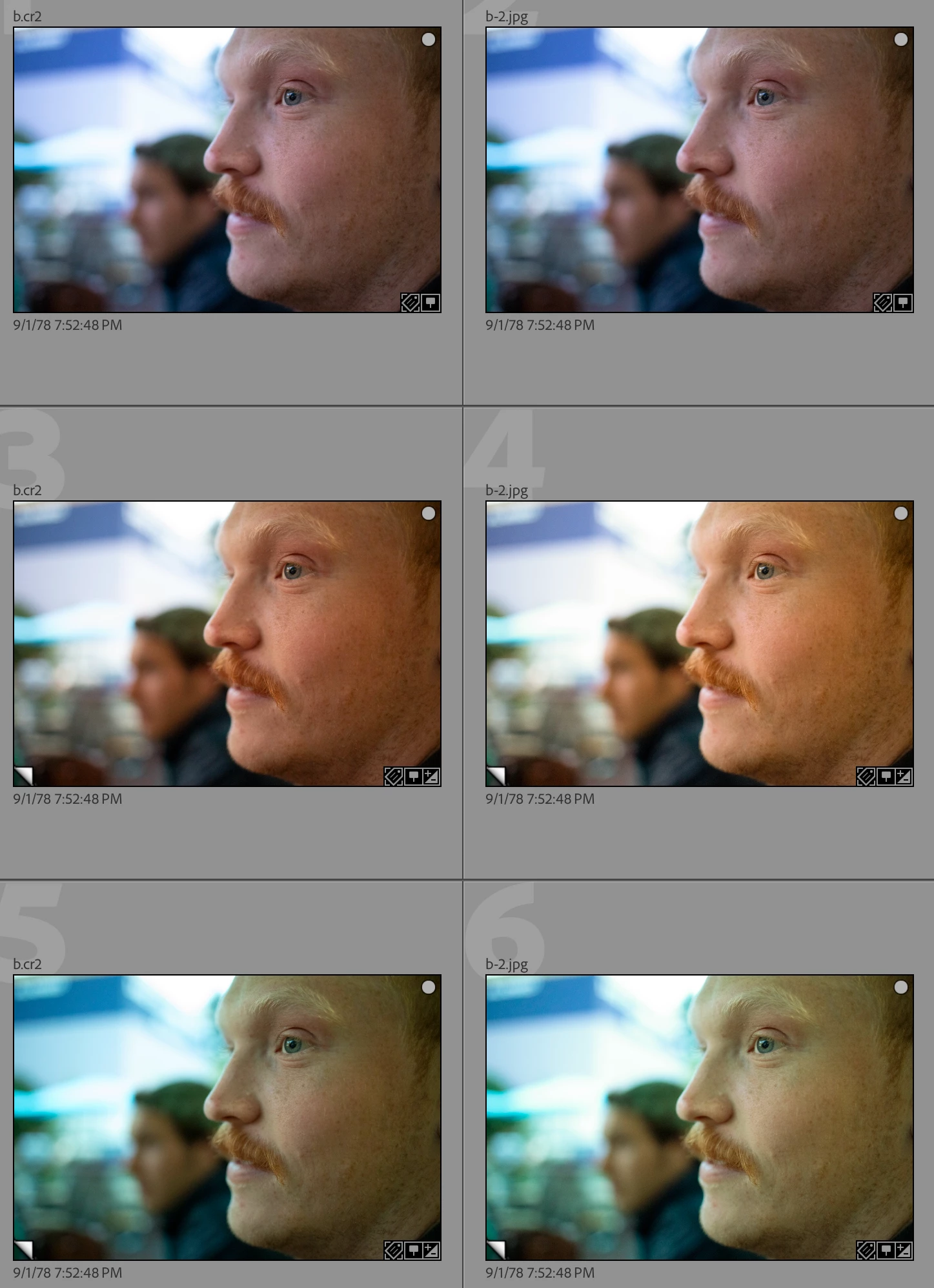

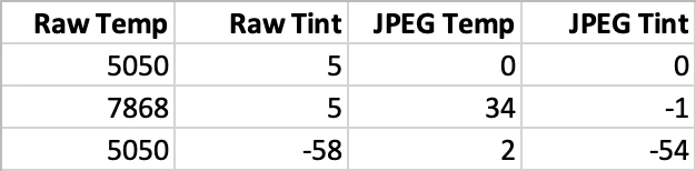

By design, when LR copies Temp/Tint from a raw to a non-raw or vice versa, it picks Temp/Tint settings for the destination that approximate the visual appearance of the source photo.
Here's an example. The first row contains a raw and a JPEG exported from the raw. In the second row, the raw Temp was adjusted and its white balance synced to the JPEG.  In the third row, the raw Tint was adjusted and its white balance synced to the JPEG:
LR sets the JPEG's Temp and Tint to approximate the visual appearance from the raw:
Given that LR is designed to approximate the visual appearance when copying Temp and Tint between formats, the copying should (but doesn't) produce the same JPEG Temp/Tint settings (different than the raw settings) whether one is using Copy/Paste, Sync Settings, presets, or the plugin SDK. The current behavior was surely not intended by the product manager.
