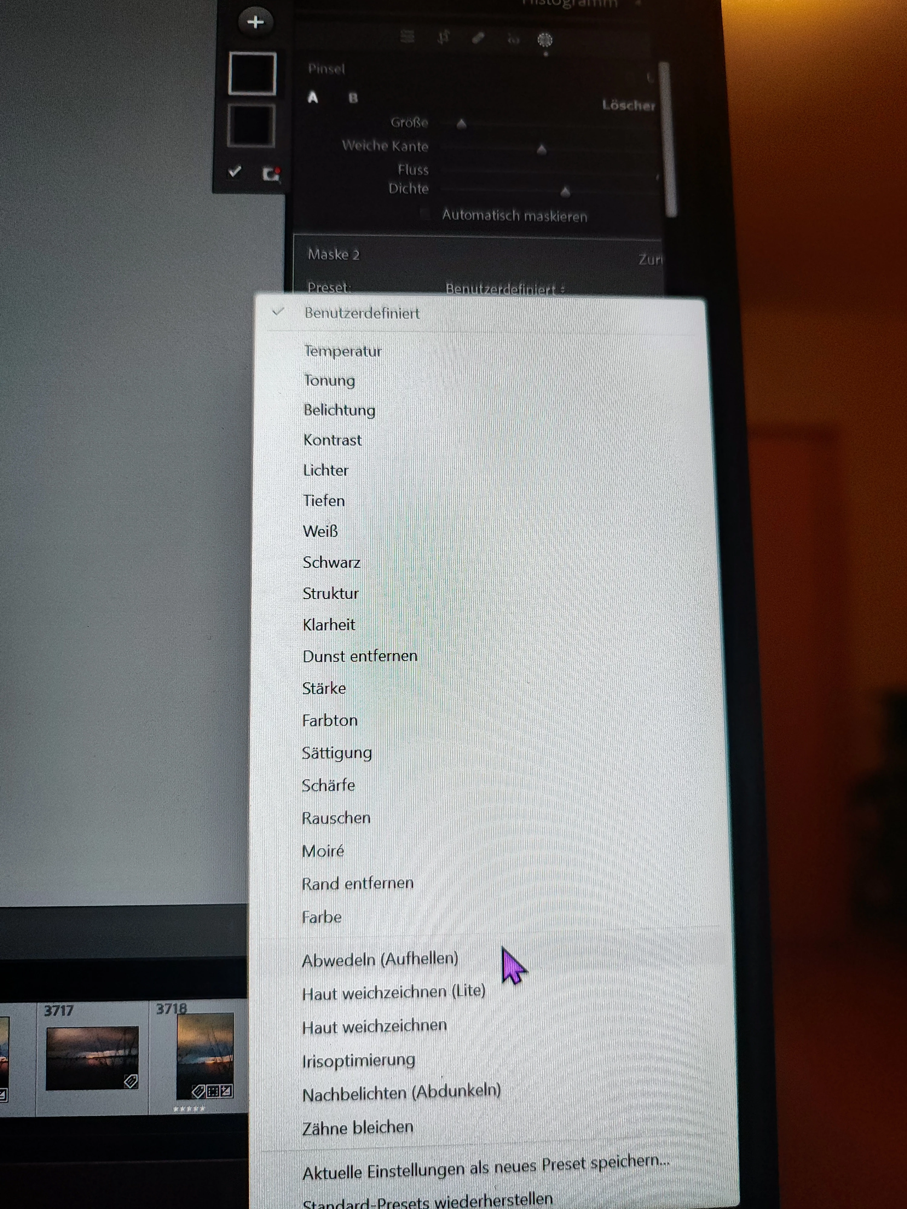

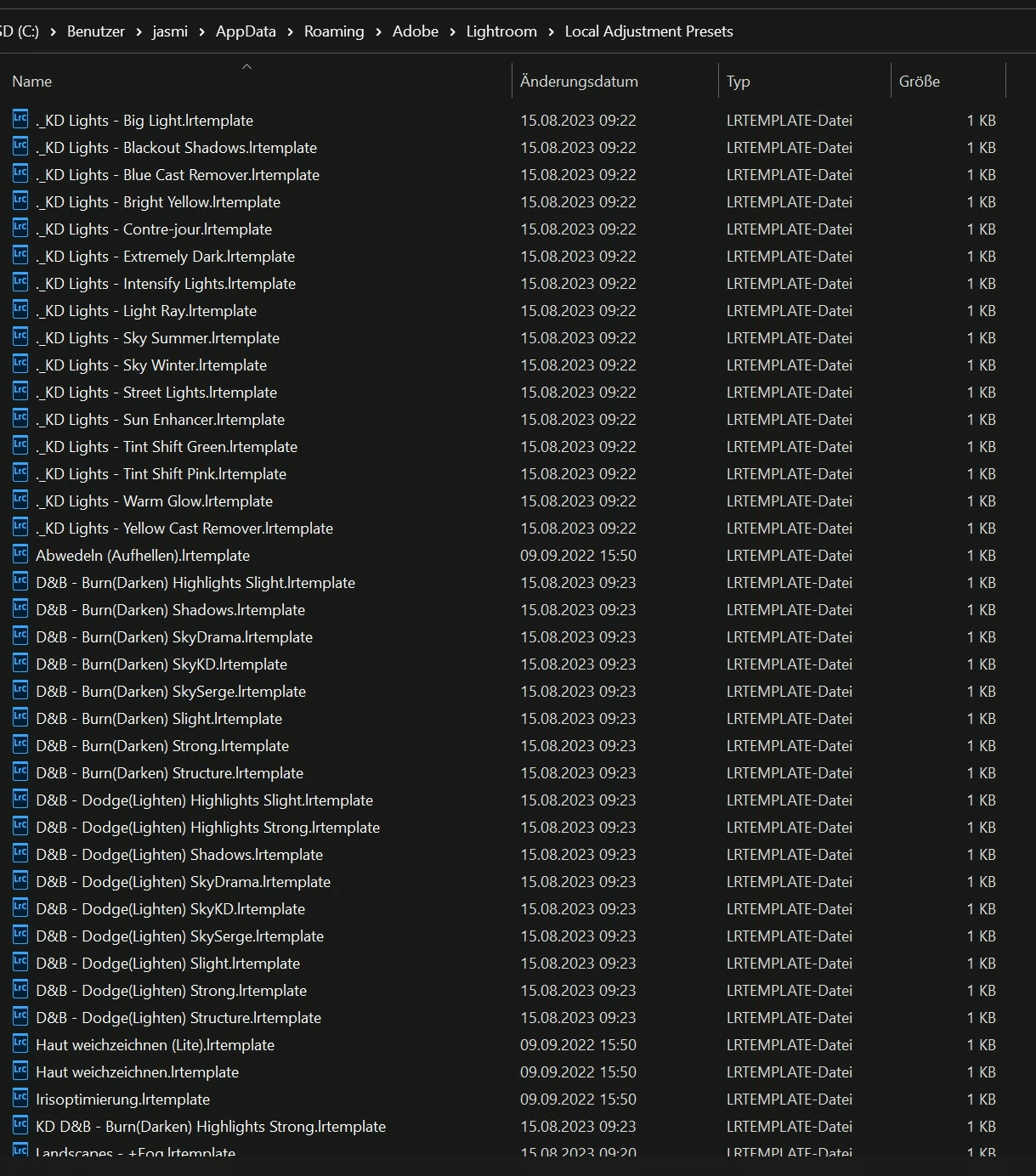

Hi zusammen,
möchte gerne Pinsel Presets installieren, bzw. habe sie in den "Local Adjustments Presets" Ordner geladen und damit sollten sie installiert sein. Es handelt sich um nicht gezippte LRTEMPLATE-Datein und in dem Ordner befinden sich weitere Pinsel, die ich in LR auch auswählen kann.
Nur die neu hinzugefügten werden mit in LR nicht angezeigt. Ich hänge Bilder an.
Kann mir jemand helfen - was mache ich falsch? Was kann ich probieren, dass es klappt und ich die Pinsel verwenden kann?

You did restart LrC after the install?
at any rate see:
https://www.lightroompresets.com/pages/how-to-install-lightroom-brushes
note that above document (link) includes some troubleshooting that might solve your issue.

Thanks for your answer. I did everything exactly as in the instructions and checked it in the troubleshooting. Unfortunately I can't find the error. The files are in the Local Adjustments folder, they were unpacked and have the same extension as all the other brushes that I see in the brushes in Lightroom. I just can't select the newly added ones in Lightroom.
I have no idea what I can do or try now.

Are you sure that these are indeed local adjustment presets, and not old versions of develop presets? Develop presets used to have the .lrtemplate extension as well, till that changed in Lightroom Classic 7. If you are sure they are the correct type, then rename one. I do not believe that file names should start with a period. That is usually a method to make them invisible. And perhaps a & in the file name should also be avoided, you never know.
