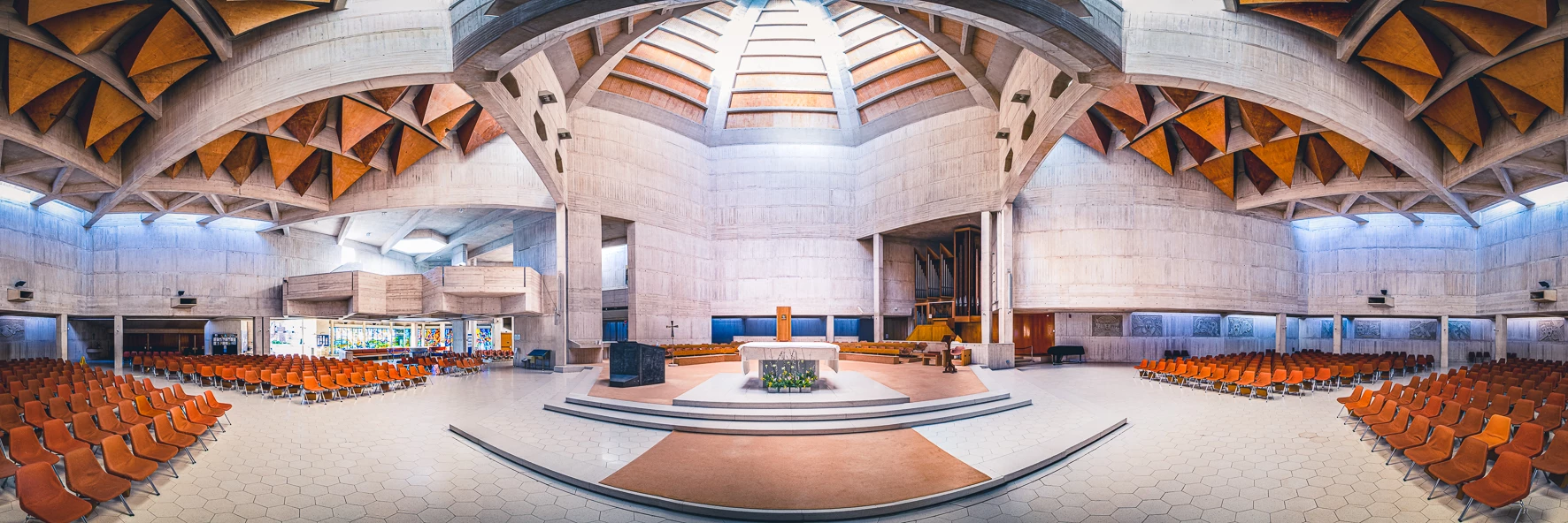

HI All,
I made a 360-degree panorama (made of 12 verticle photographs) of a Cathedral. I want to place the altar in the middle of the finished panorama. Right now it is on the right-hand side. See enclosed photograph.
Unfortunately, both Lightroom and Photo>Edit>Merge to Panorama in Photoshop, place the alter at the right-hand side of the frame.
Does anyone know how I can place the altar in the centre of the finished photograph?
Geoff

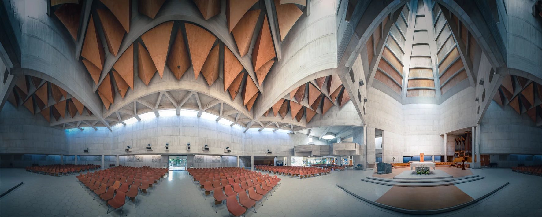

geoffl18657010
February 19, 2023
My thanks to everyone for your replies. I tried Bob's suggestion (below) but the alter stayed, first at the right side, then at the left.
I had photographed the Cathedral as a panorama using several different lenses (Samyang 24mm Shift Lens and Nikon 12-24mm zoom).
In the enclosed photo, I used my Samyang Shift Lens mounted approx 12 feet on my Surveyor's Tripod (much cheaper than the camera brands and they rise much taller). It just 'happened to work' as a panorama with the alter in the middle!
Thanks again, Geoff

geoffl18657010
February 20, 2023
Yes, you are right. I should have explained that I did the same panorama several times, each time using different lenses.
I hope that clarifies.
