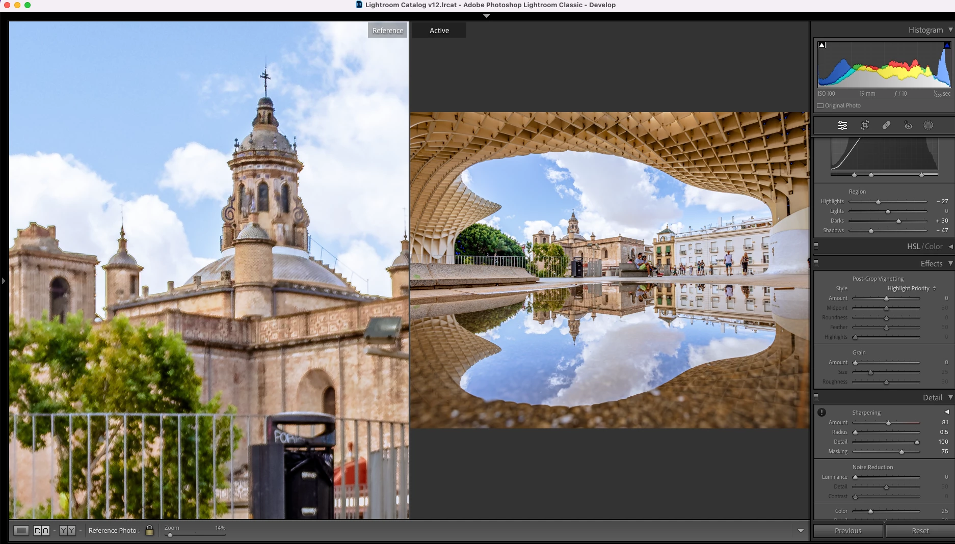

Before I post this as a "bug" I want to check with the community that I'm not missing something.
When using reference view in the Develop module I can control the zoom on the sliding scale in the "active" image but the "reference" image zoom can only be seen at 100% or "fit".  Furthermore the padlock symbol doesn't seem to do anything. I would have expected the zooms for both images to lock just like in the Compare view. Am I missing something or is this a bug?

The new Reference view in the Develop Module includes an Zoom slider and a Padlock located on the Toolbar. The padlock can be locked or opened with a click but it appears to have no effect. I'd expect the padlock and zoom to work together to synchronise the zoomed amount on the Reference and Active windows (just like it does in the Compare view).  What I'm seeing is a Reference window that is either in "fit" mode or 100% regardless of the zoom setting for the Active window, and a padlock symbol that has no effect on anything.
I can also find no effect of choosing View>Lock Zoom Position from the menu bar (Shift & cmd & =).
......a minor quibble to an excellent new feature. Thanks.
Lightroom Classic v 12.0.1
MacOS Monterey v12.8
Mac mini 2018
3.2GHz 6 core Intel Core i7
16GB memory
Intel UHD graphics

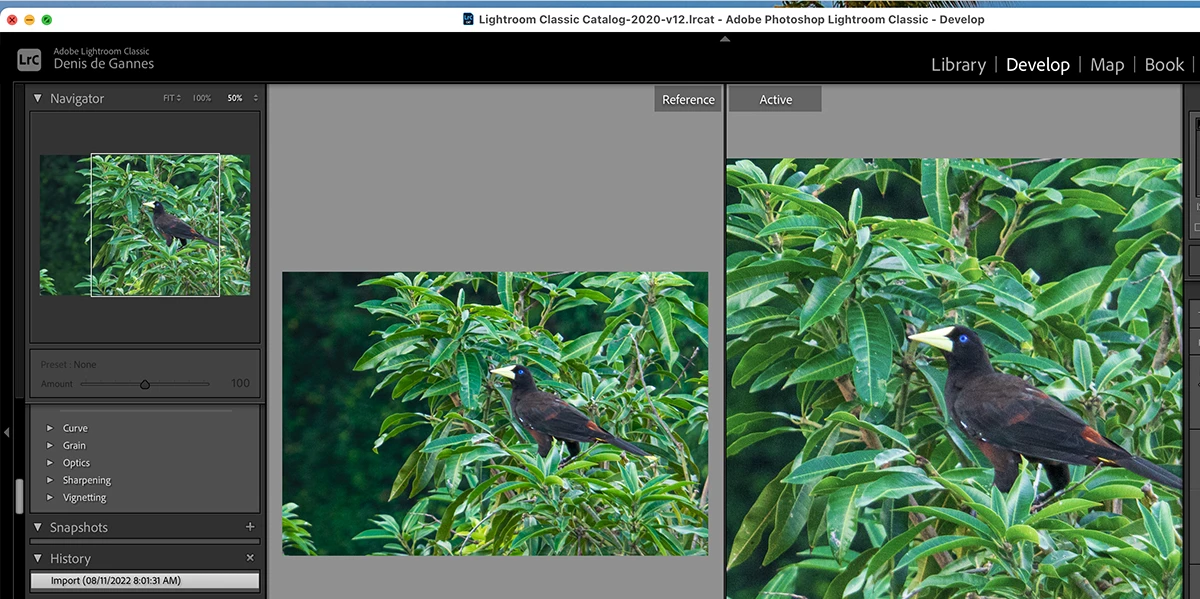

I do not usually use this feature in my workflow so, I do not fully understand what you are experiencing is a Bug. Please provide the version number of Lightroom Classic the macOS operating system you are using.
I did the following on my system (details in the signature line), the Reference file is an Enhanced DNG file and the Active file is TIFF file created after sending the Referenced file was sent to PS and a filter applied. Both files have the same Pixel dimensions.
If I select the fit option the two files are displayed side by side and no problem is evident. However, if any sizing is applied 100%, 50%, or whatever is used only the Active file is adjusted. I am not aware if this is as designed or is a Bug.
The Compare feature is completely different, you are comparing one file. The original import look and the look after further edits.
See the screen capture with 50% applied.
Regards, Denis: iMac 27” mid-2015, macOS 11.7.10 Big Sur; 2TB SSD, 24 GB Ram, GPU 2 GB; LrC 12.5,; Lr 6.5, PS 24.7,; ACR 15.5,; (also Laptop Win 11, ver 24H2, LrC 15.0.1, PS 27.0; ) Camera Oly OM-D E-M1.

Your screenshot doesn’t show the Toolbar which is where the “problem” lies. See my screenshot. The toolbar has a zoom control which, as expected, allows a full range of zooming on the “active” image. On the “reference” image, the zoom allows only 100%, or fitting the screen. I know that Reference view and Compare view are different tools but I would have expected the zoom and padlock to behave in the same way on each tool.
As mentioned in my original post, the behaviour of the padlock (open or closed) seems to make no difference to anything. The fact that there is a padlock in reference view would suggest to me that it should allow synchronised zooming of the active and reference images - just like in Compare view.....unless I'm missing something!
Mac mini 2018
16GB memory
Intel UHD graphics
