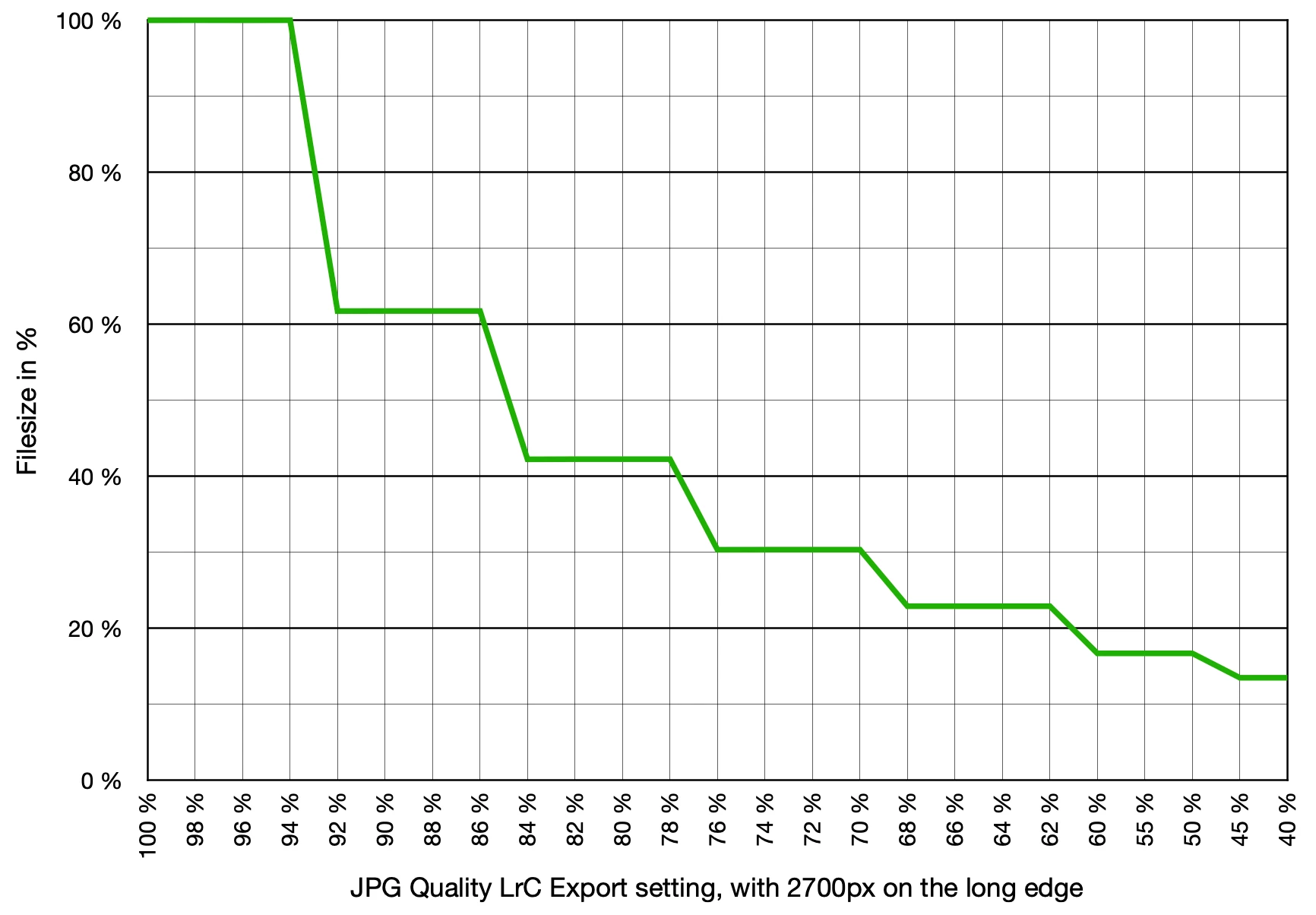

Hello Marcel,
I did once a small study.
I took 100 photos, different subjects and exported them from Lightroom Classic 11.x
Base photos were DNG, converted from CR2 (Canon 5D Mark IV).
All other settings were identical, I only changed JPG quality.
The result: The JPG quality does not correlate 1:1 to the final filesize of the exported JPGs.
My recommendation would be:
1. Check what resulution you really need. I view most of my pictures on my laptop, therefor I went with 2700x1800px. If you use a 4k screen you should use higher resolution.
If I need them in higher resulution / quality I can still export them for this special purpose, because I still have originals in LrC.
2. Export a few examples of your pictures in 100% and 75%, change there names during the export in 100P_001, 100P_002 ...  075P_001, 075P_002. Renaming will ensure that you know the settings and that Lightroom will import then, without rejection.
Then import these JPGs back in Lightroom and compare them side by side at magnification 100%, 200% & 300%. As soon as you don't see any fragmentation in the JPGs you found your limit.
If 75% is not OK go higher, if OK go lower.
Based on this limit you can then define your export setting.
Let me know at what level you saw the first fragmentation, that is no longer OK for you.
