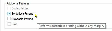

'Borderless' needs to be set in the Printer Page Setup dialog.
Even my 'cheap' Canon TS8200 inkjet has the borderless option.

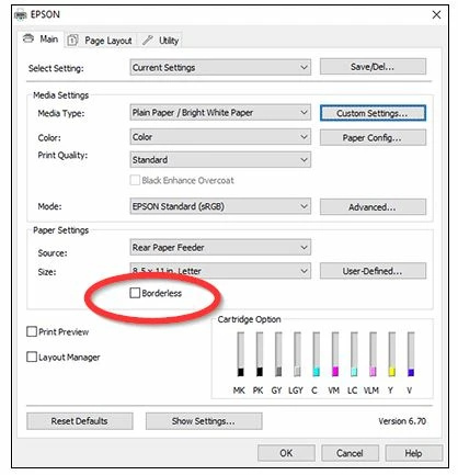

My printer is an Epson 900 and is about 6 months old.  I simply can not figure out how to find these settings.
Rob_Cullen
August 4, 2022
In the P900 User Manual under "Setting Default Print Settings"- there is this dialog illustrated-
