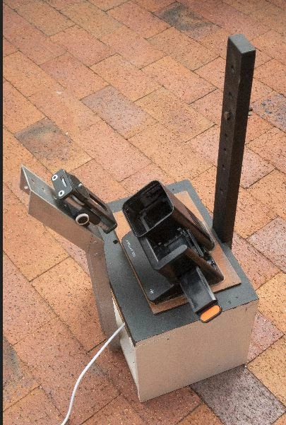

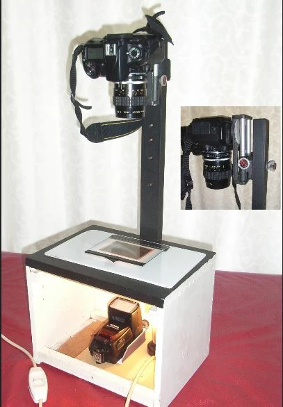

My DIY propensity has resulted in these contraptions-
My flash is wireless and TTL, or I use a LED light. Large negs can be copied on the flat glass (over the opaque 'perspex')
35mm slides I can shoot with an old modified slide viewer (Glass and lower case removed) which allows me to push each slide through and shoot in seconds, 20 or so loaded in the viewer.
I once did a 5000 copy shoot in one day (for a client) using this rig.
