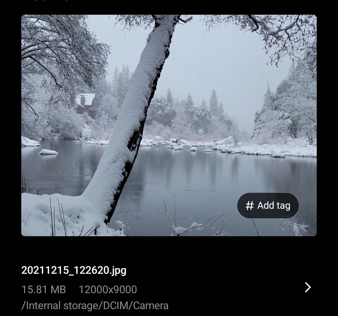

This in my original jpg, the file manager shows its size at 15.81MB (12000x9000)

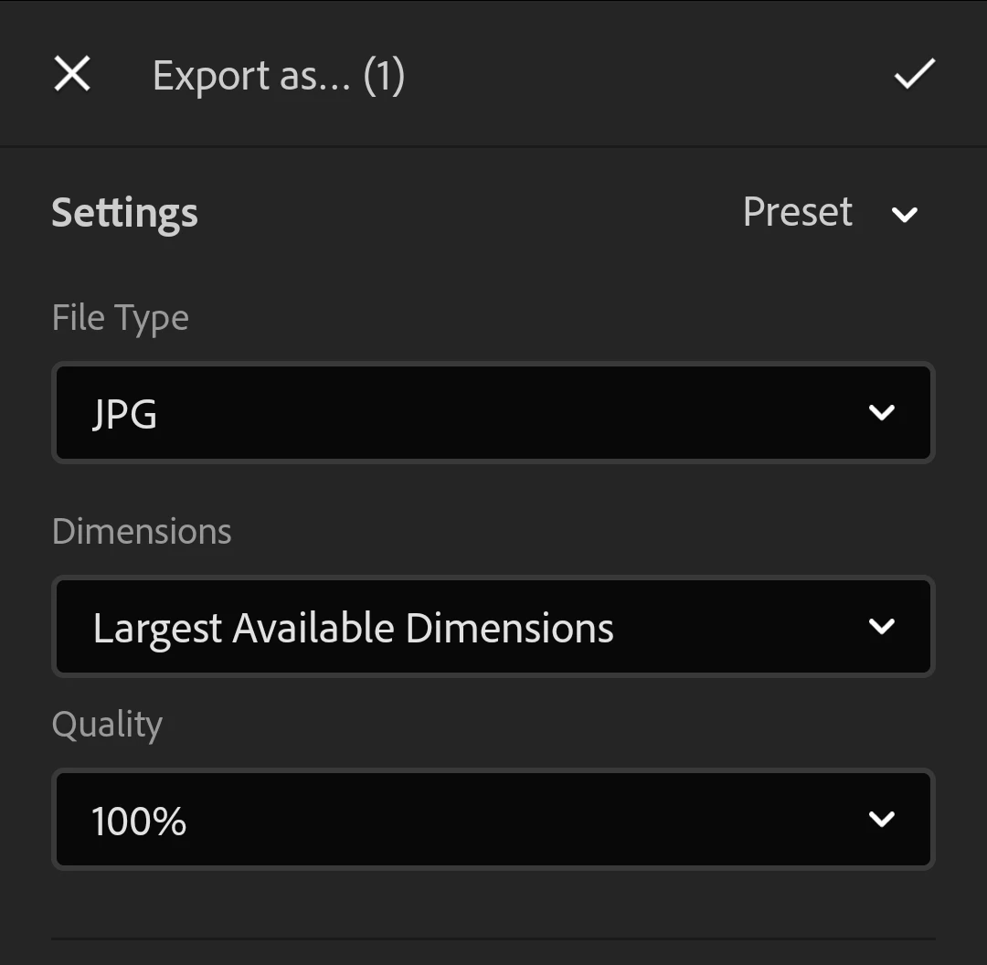

I made my edits (which were minimal) within LR Mobile and used the above export settings. File type: jpg, Dimensions: Largest Available, Quality: 100

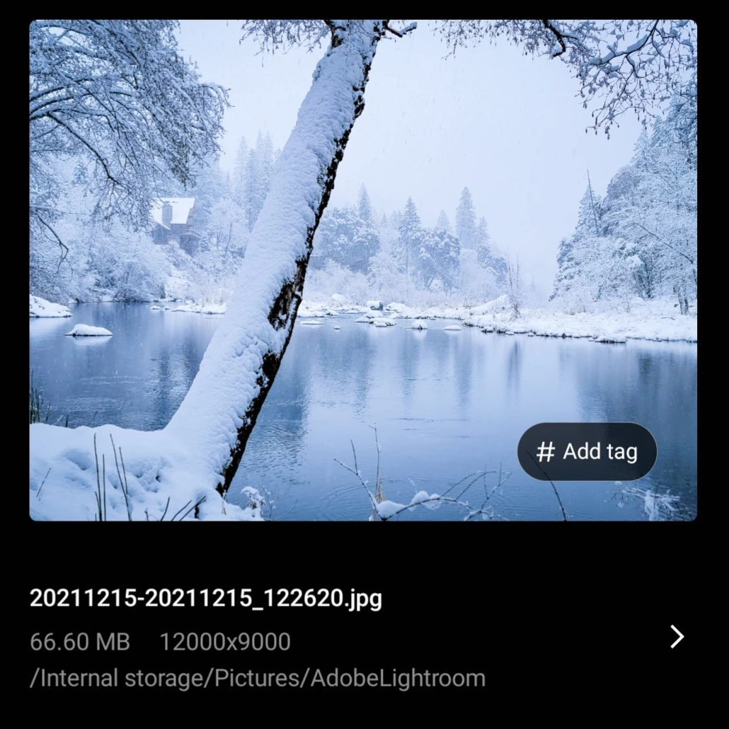

This is the image LRM produces after several minutes of processing. The file manager shows it's size now as 66.6MB (12000x9000).

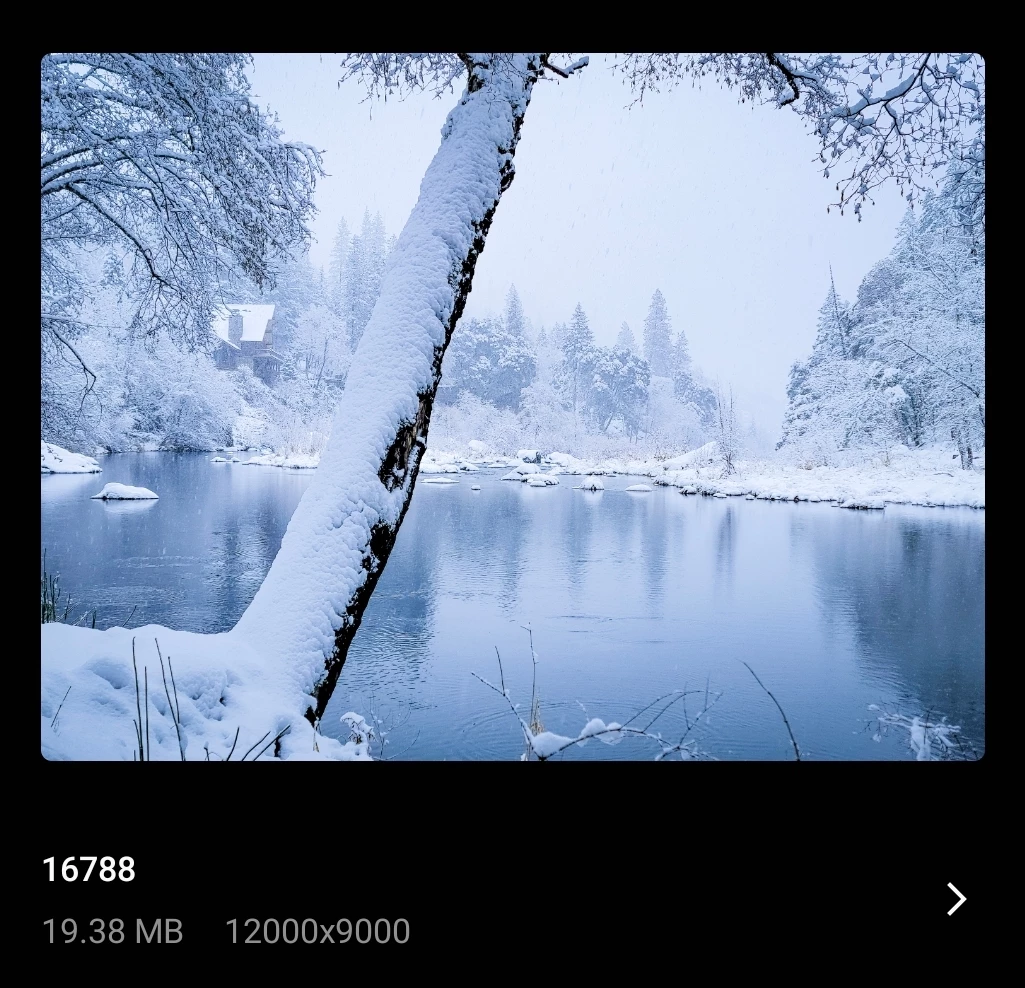

If I go to LR Web it shows my file with the all my edits from LRM.  When I used the LRW download button and choose "JPEG (Full Size) Latest Edits" it will download the above file which is now 19.38 MB (12000x9000).
