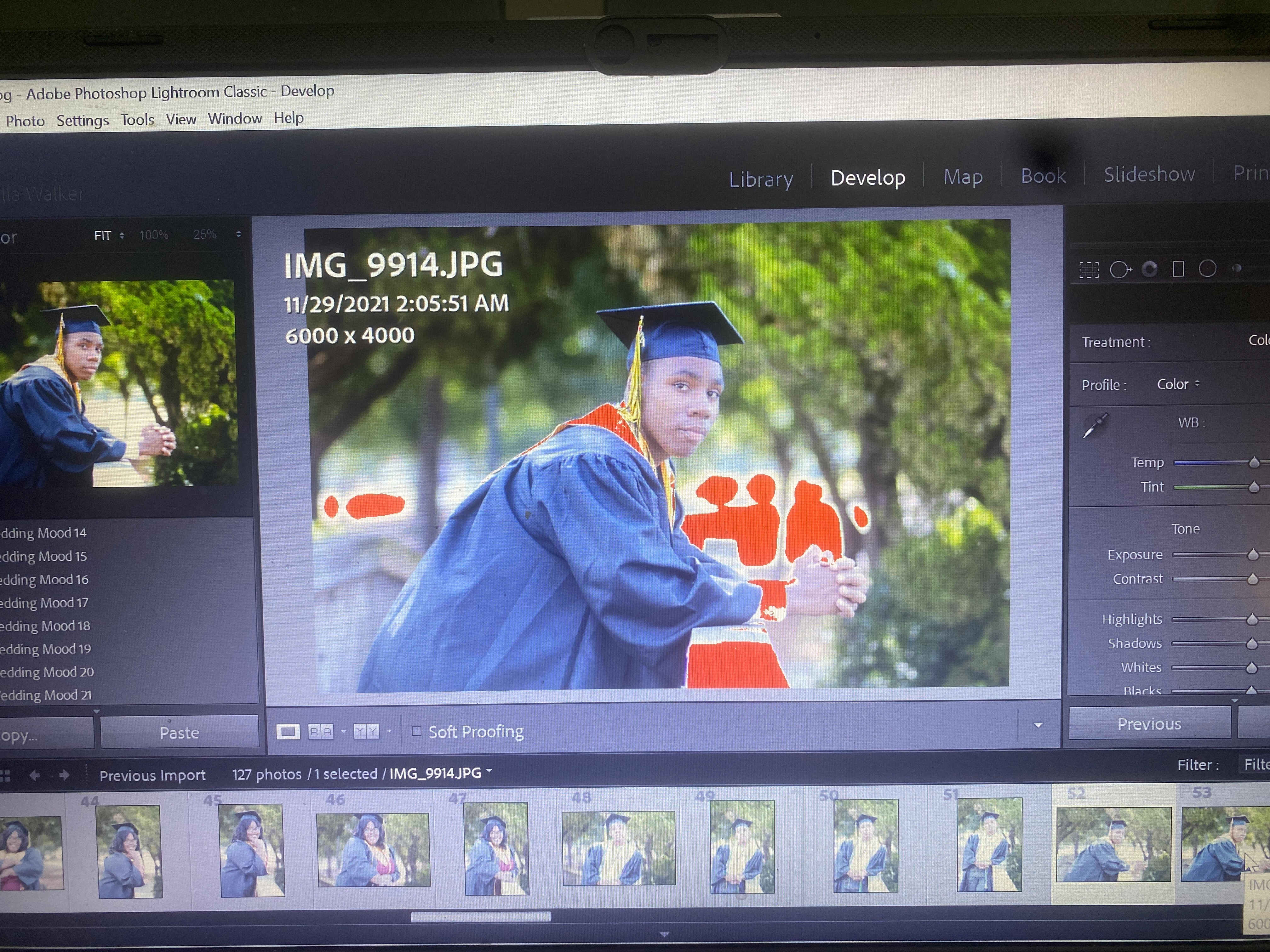

LightRoom classic color on image
  • June 5, 2021
  • 371 views
Does anyone know how I can remove this? Idk how it got up here.
Correct answer JP Hess
The red areas that you see in that image are areas that are overexposed in tthe white area and are clipped. The red is the clipping indicator that is built into Lightroom. There is also a blue clipping indicatoor to indicate shadows that  are being clipped. These indicators can be turned off by pressing the J key. Alternatively, you can click on the little squares In the upper corners of the histogram to activate/deactivate the indicators individually.
