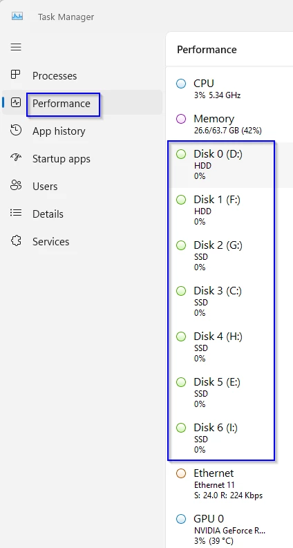

 it doesn’t activate at all in task manager
By @Gene27167201cqus
Hi Gene.  Can you clarify the above? Do you mean in the Task manager > Performance tab?  (I am using Windows 11, so your's might be different.
The PSB format id ascociated with large file sizes.  Do you know what the size of the problem file(s) is?
It sounds like you have been able to select the new drive as Scratch space.  Is that right?
Open File Explorer and look at that drive's root directory, and see what size the Photoshop Temp file(s) is/are.  With the PSB file loaded in Photoshop. Look for activity on Performance Monitor and see if you can see any bottlenecks.

@Trevor.Dennis
Hey, yes I was able to see that the nvm has 24gb of temp file when running PS, but it doesnt show the NVme actively being used in perfomrance task mangaer like the ram shows a 100% kind of thing.
