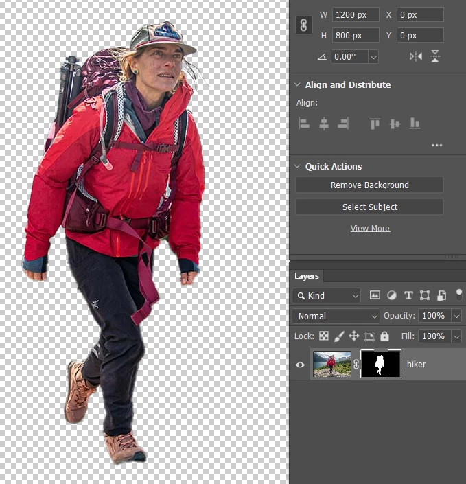

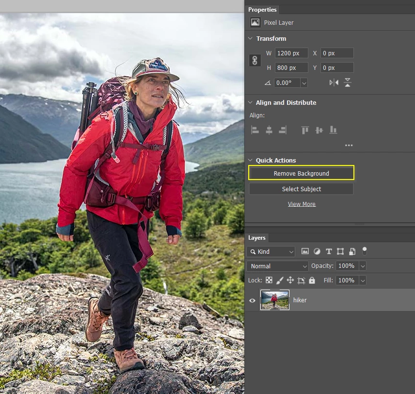

Find a suitable image of the person, and open it in Photoshop
In Properties panel, click on Remove Background
As you can see, it does a stellar job.

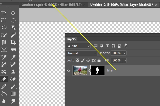

With your landscape image also open, drake the cutout human layer to the landscape tab as below
Move it into position and resize with Free Transform (Ctrl T)
You can see that I have flipped the hiker to face the other way with Free Transform

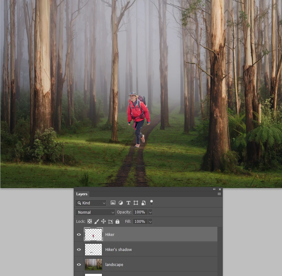

To make the scale look right, the persons eyeline should be close to where you think the horizon would be.
Add (paint in) a shadow, and you are done.

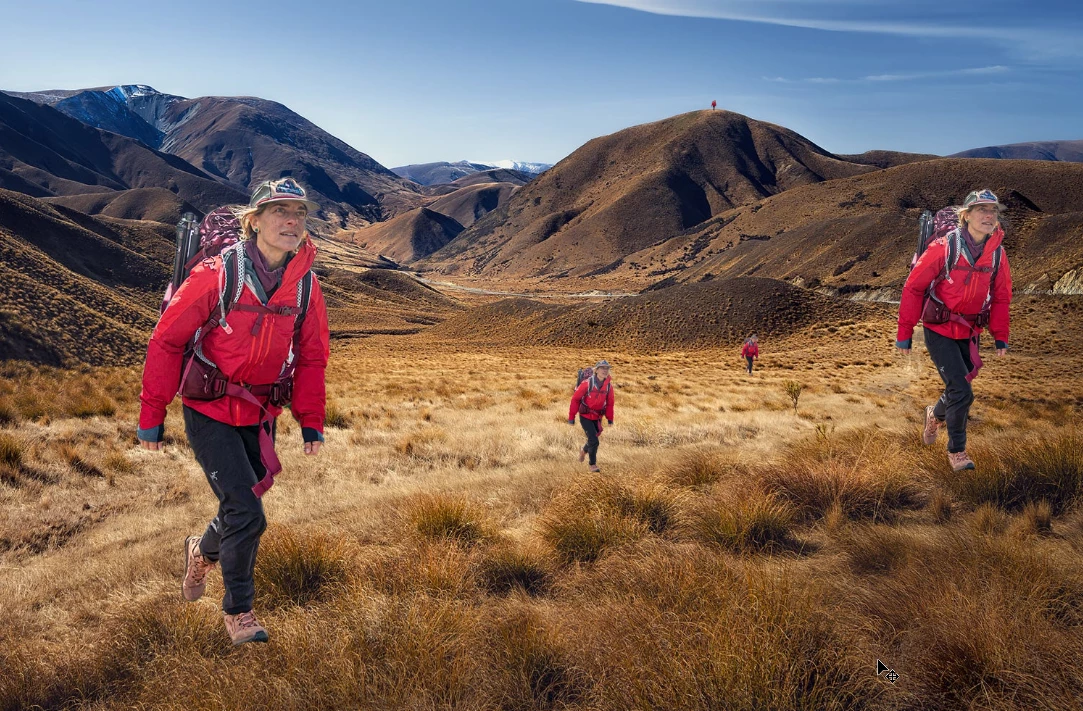

Exactly the same thing.  Make the person as small as you like so long as it is somewhere close to the image perspective.
The image above has differing levels, but the one below is nearer to level ground and shows how the eyeline needs to intersect the horiszon.  It doesn't need to be perfect, but is a good guide.
