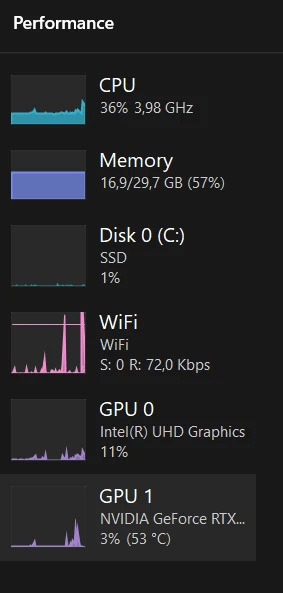

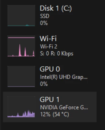

The first potential issue might be the use of the integrated GPU that the Intel CPU has, instead of the 4070 to run these programs. Are you sure the 4070 is the one being used? You can open up Task Manager on the Performance tab side by side with Photoshop, then go to the crop tool and start rotating the view. Do you get a performance spike on the 4070 or the Intel GPU? Should be like this:
November 14, 2024
Yes just checked twice, GPU is being used while working. Eg. crop tool

November 15, 2024
Yes, as @D Fosse noted, the fact that the Intel GPU is getting any load % means it's also being used and could be causing issues. You can follow the steps outlined here (point 6 - configuring Photoshop & Illustrator to only use the Nvidia GPU, or if needed point 7 - disable the integrated graphics completely).
Forcing the Nvidia GPU without disabling the integrated graphics has worked fine for me for laptops in the past, but disabling it completely is likely the safest option to ensure you're always getting the best performance in all apps. Not sure how much it impacts battery life if that's a concern.
