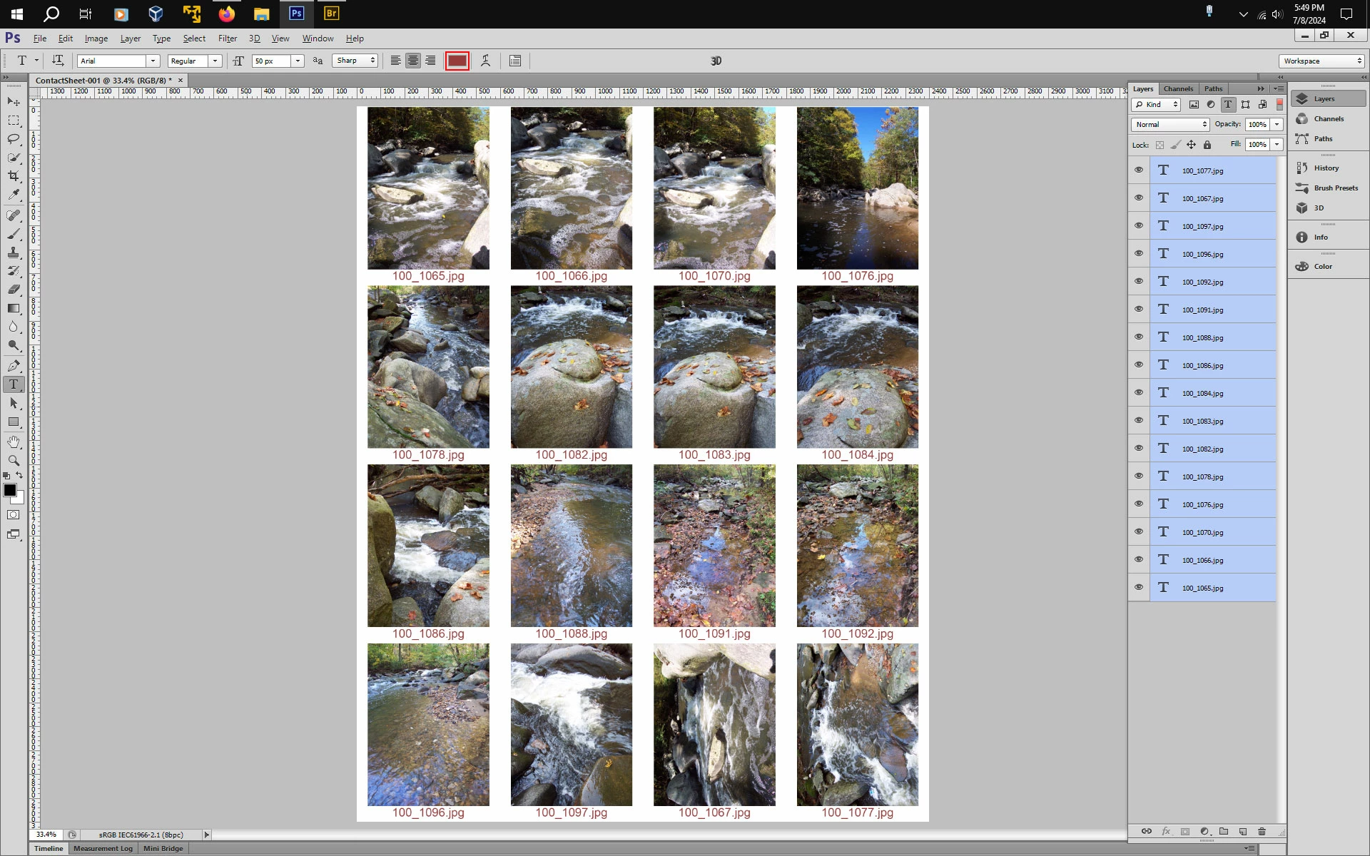

It depends on how many text layers you have, so you can select your first text layer then Ctrl click on every other text layer till they are all selected. (Ctrl click to the right of the layer name to select a layer)
or

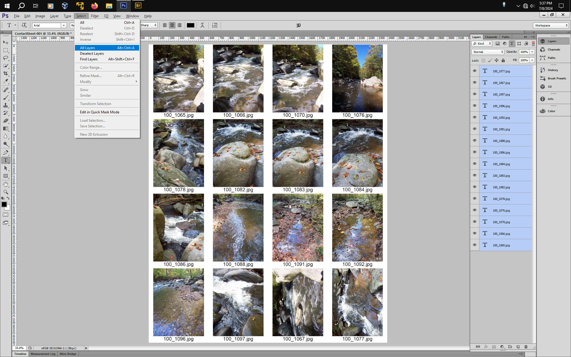

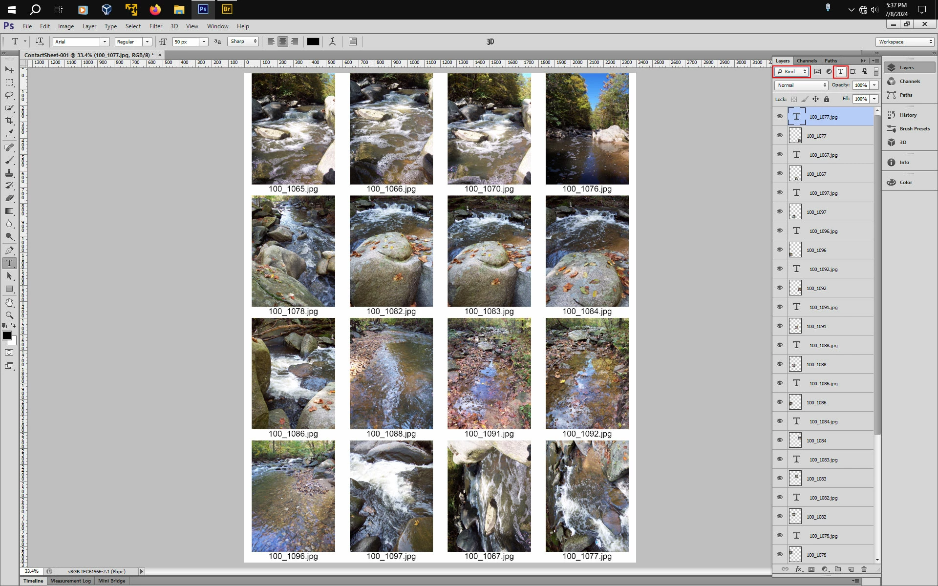

Click on Kind in the layer filter, click on the T, then go to Select>Select all Layers.
Then click on the Horizontal Type Tool in the tools panel and click on the color swatch in the tool options bar to change the color of all the text layers.
