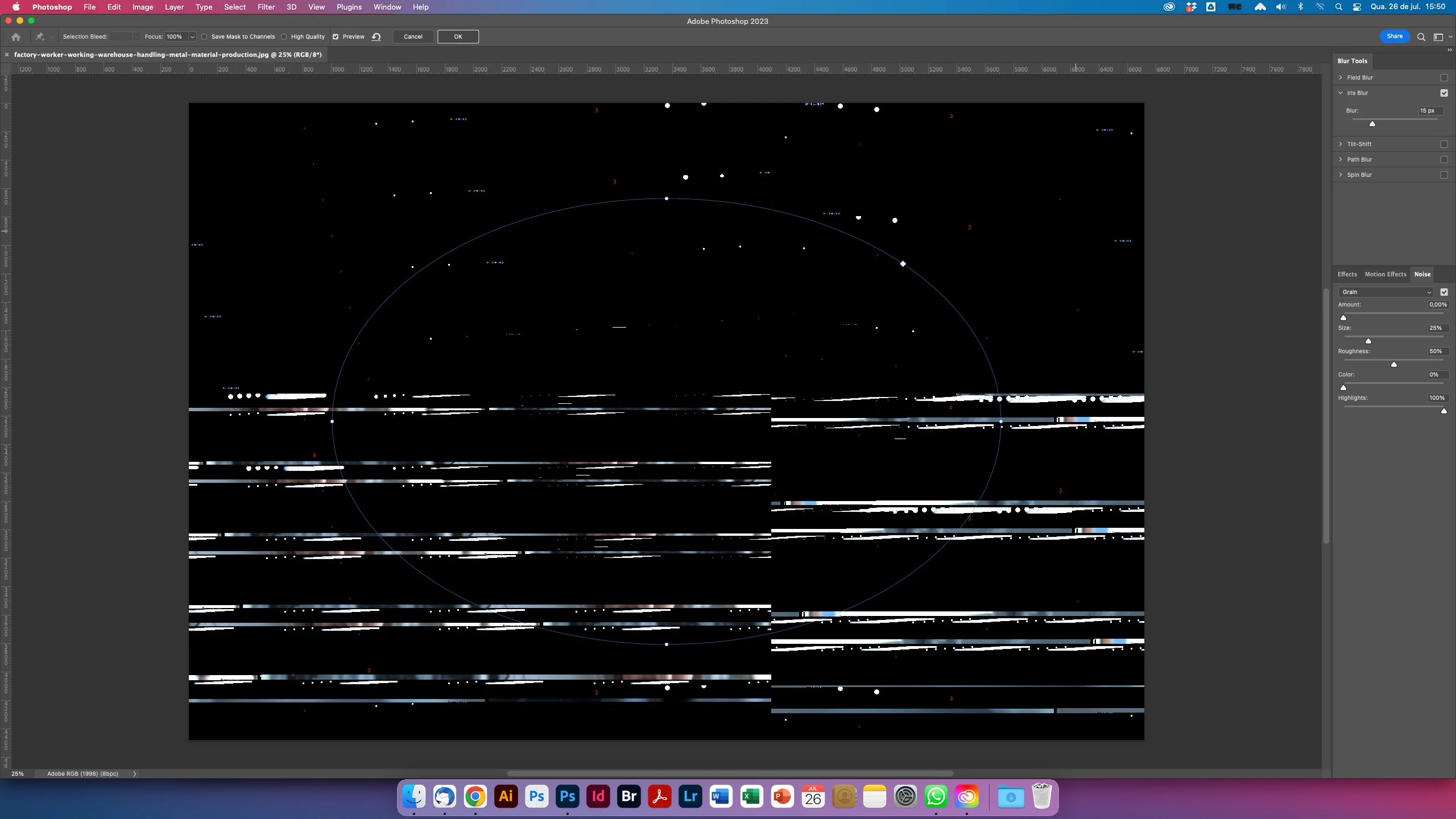

Atualizei o Photoshop para a versão 24.6.0 e desde então tenho problemas na galeria de desfoque.
Ao tentar aplicar alguma das ferramentas de desfoque, ocorre uma falha na imagem conforme o anexo, e se tento editar as propriedades, o photoshop fecha.
O que pode estar acontecendo?
Utilizo o macOS Big Sur 11.7.8.

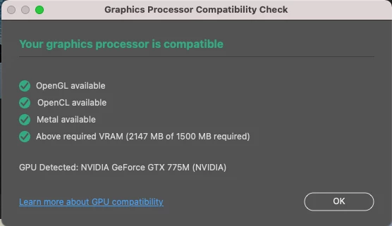

Hi juplens,
Please go to Preferences > Performance > uncheck, “Use Graphics Processor” and restart Photoshop.  I know the GPU compatibility report is showing the GPU is compatible, but this type of issue is often GPU related. Thank you.

Funcionou! Muito obrigada!

July 26, 2023
"Your graphics processor is compatible."
Kevin Stohlmeyer
July 26, 2023
Offhand I'd say its an issue with your graphics card. Go to Photoshop Help Menu/GPU Compatiblity - what does the report show?
