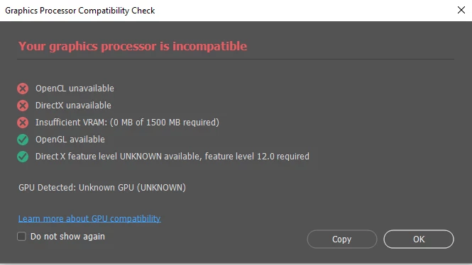

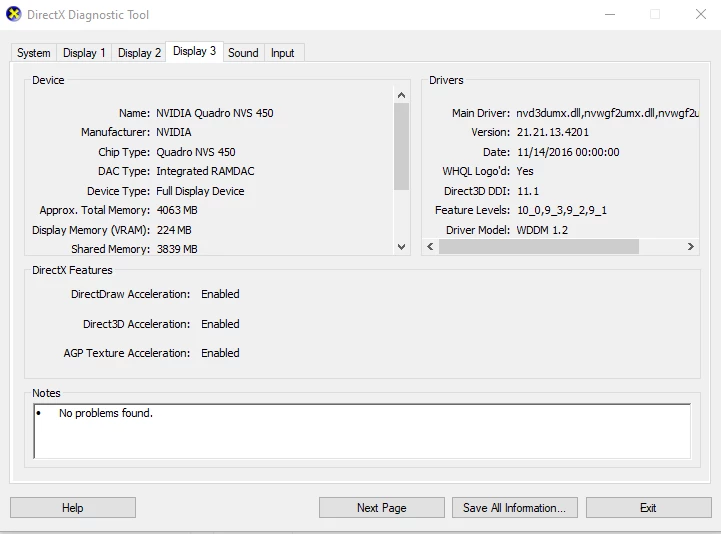

Hi all. I wonder if someone could help. I have just taken out a free trial on Adobe Photoshop, I am wanting to create some pet portraits (taking a photo of a dog/cat etc and putting into an historical oil painting). I am unable to open the Oil Painting section on filters. When opening Photoshop I am told OpenCL is unavilable as is DirectX and I have insufficient VRAM. I am not a computer genius, but it is obvious my NVIDIA Quadro NVS 450 is not good enough!!! However I have seen some graphics cards costing many hundreds of pounds, so would appreciate some advice on a decent graphics card I can buy that would do the job. My computer uses an Intel(R) Core(TM) i7-3770 CPU @ 3.40GHz 3.40 GHz with 32.0 GB ram.

The Quadro NVS 450 was released in 2008, so yes, well overdue for replacement. It is nowhere near meeting Photoshop's current requirements.
The optimal GPU for Photoshop today is the Nvidia RTX 40- series, ranging from the inexpensive 4050 to the high-end 4090. The sweet spot is probably the RTX 4060. It has plenty power for Photoshop, while still not being very expensive. As a budget option, the RTX 4050 should also work well.
If you can find the older RTX 3060 it will work well too, and probably a bit cheaper since it's an older product.
Just to avoid any surprises, check that the physical measurements fit into your current case. You also need to have an 8-pin PCIe power outlet/cable (standardized pins) directly from your power supply. The power from the motherboard slot is not enough (as it was with many older GPUs). A power supply of 550 watts is minimum.
