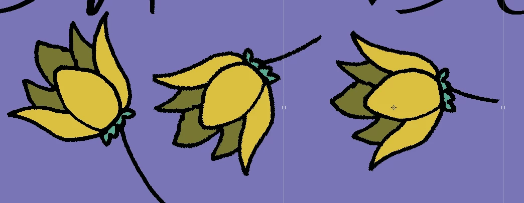

2. I have just tried this on this simple flower - see image - the first one it the original, second layer copy just rotated slightly and third layer copy converted to smart rotated. As you can see the pixellation is really bad just from rotating I haven't edited at all.

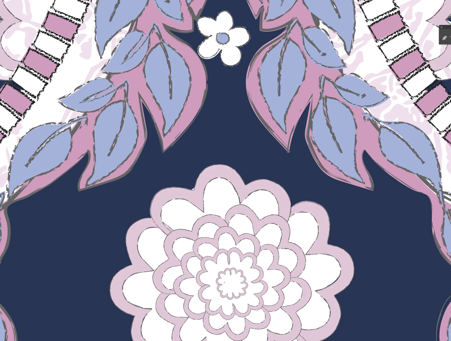

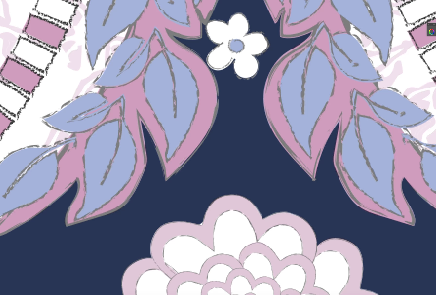

4. Another example: I created this pattern in illustrator - due to needing to use the illustrator brushes. see image 1. zoomed in on illustrator
I then opened up the file in photoshop to recolour as it would be easier to just select colour groups and recolour and i was also thinking about putting an effect on the print. Just opening the print in Photoshop you can see the difference in quality.
This is a print that would be 32cm x 32cm so needs to be clean as it is large. Impossible to recolour as so pixellated and more than one colour in the lines alone
Any suggestions on whats causing this?

D Fosse
December 29, 2016
Photoshop is pixel-based. It doesn't care about physical dimensions, only number of pixels.
Illustrator is vector-based (mathematical formulae). It doesn't care about pixels.
IOW, you need to make sure the Photoshop document has enough pixels to fully resolve the vector paths.
