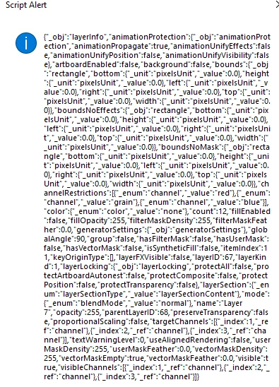

and in case someone wants to follow along
	s2t = stringIDToTypeID;
	var r = new ActionReference();
	r.putEnumerated(s2t('layer'), s2t('ordinal'), s2t('targetEnum'));
	var d = new ActionDescriptor();
	d.putReference(charIDToTypeID( "null" ),r)
	d.putObject(s2t('object'), s2t('layerInfo'), executeActionGet(r));//
	alert(executeAction(s2t('convertJSONdescriptor'), d).getString(s2t('json')));
	var e = executeActionGet(r);
			var str = ''
	for (var i = 0; i < e.count; i++)
	{ str += typeIDToStringID(e.getKey(i)) + ':' + e.getType(e.getKey(i)) + '\n' }
	alert(str);
this is the script im using to read through the objects ("layer") in this ocasion to get this readout of its contents which are suspiciously lacking timeline information :
