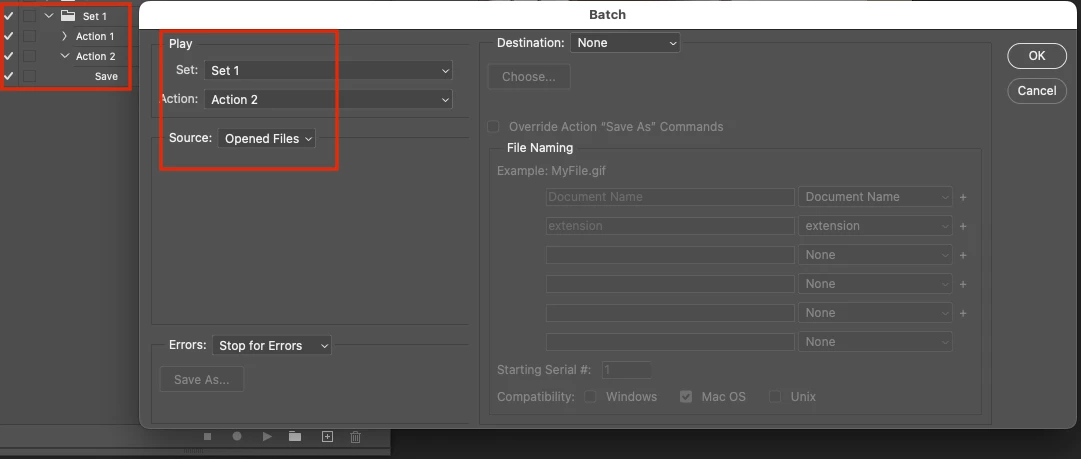

You can do this by combining two forms of automation which are more accessible than scripts.
1) Create an action, use the action panel menu item to "insert menu item" and select File > Save. Stop recording the action.
2) Next, use the File > Automate > Batch command to run this action set and action on all open documents:
