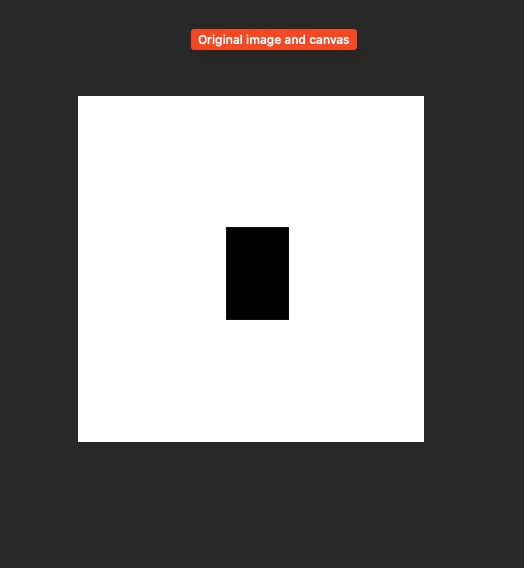

So basically I have to resize 300 layers to 3000px using the largest size (width or height, whatever is bigger).

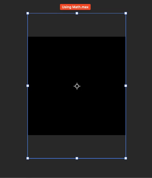

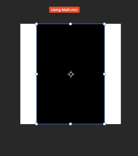

EDIT: I found the script that does this, but it needs a subtle change as described by the script's author @Stephen Marsh (thank you for your contribution, Stephen).
Use the following script (the original script used "Math.max" and I changed it to "Math.min" to fit the largest dimension to the canvas):
// https://forums.adobe.com/thread/1968642
// https://forums.adobe.com/message/8022190#8022190
#target photoshop
var oldPref = app.preferences.rulerUnits
app.preferences.rulerUnits = Units.PIXELS;
var doc = activeDocument;
var iLayer = doc.activeLayer;
doc.activeLayer = iLayer;
var scale = Math.min(doc.width/(iLayer.bounds[2]-iLayer.bounds[0]),doc.height/(iLayer.bounds[3]-iLayer.bounds[1])); // Optionally change Math.max to Math.min to fit canvas short side
iLayer.resize (scale*100,scale*100);
iLayer.translate(doc.width/2-(iLayer.bounds[0]+iLayer.bounds[2])/2,doc.height/2-(iLayer.bounds[1]+iLayer.bounds[3])/2);
app.preferences.rulerUnits = oldPref;
To make it clear what the Math.max and Math.min do:
