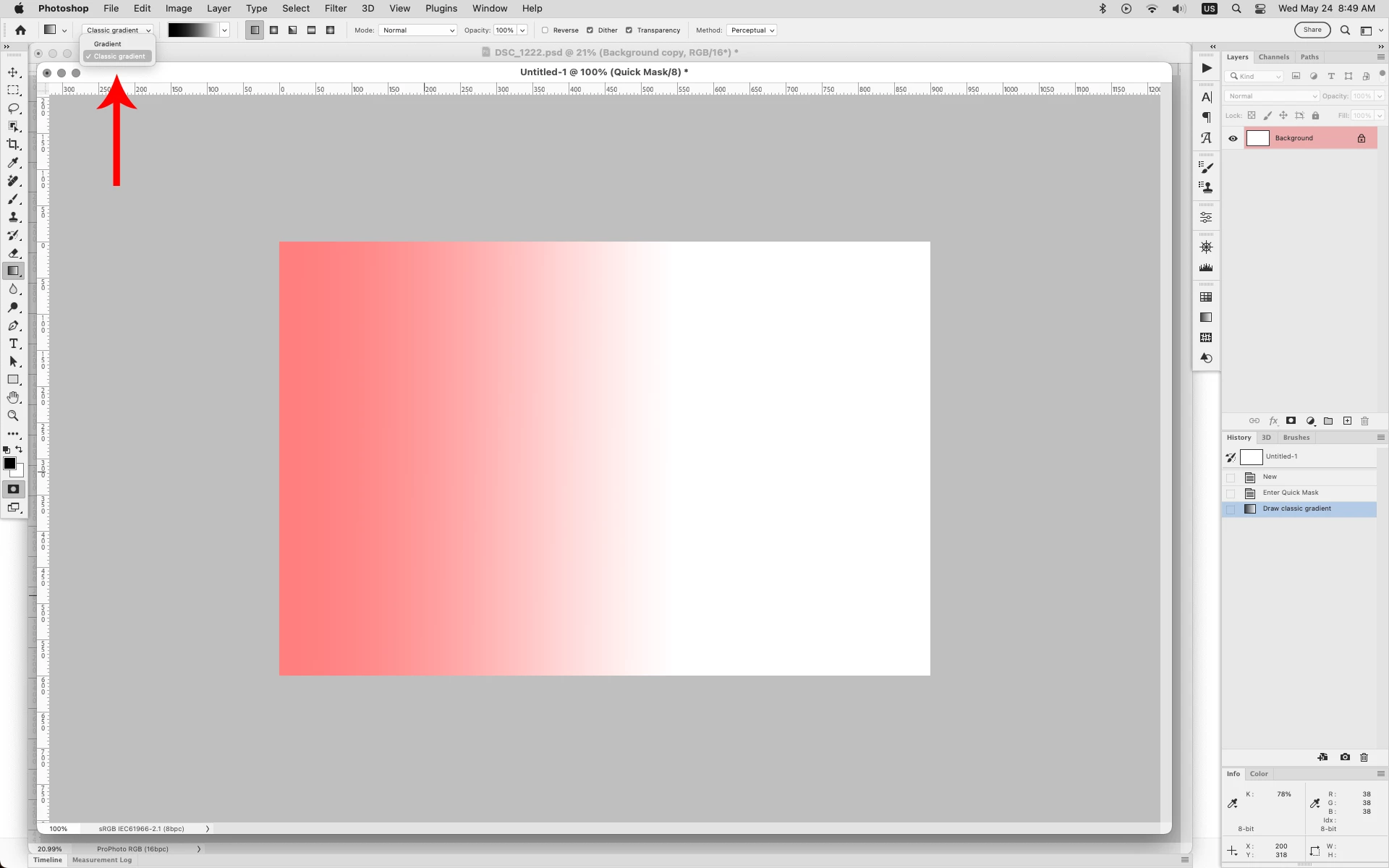

Jeff Arola
June 20, 2023
The New Gradient Tool creates a new Gradient Fill Adjustment layer where you can adjust the Layer Bend Modes and/or Layer Opacity.
If you want the old style Gradient Tool with the Mode and Opacity in the tool options bar, switch to Classic Gradient before drawing out your gradient.
