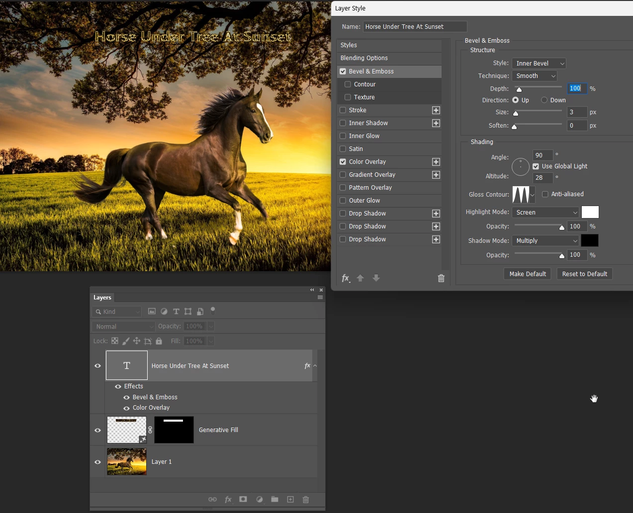

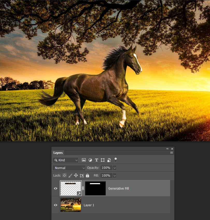

I made the text in this moke up hard to select
Generative Fill did an excellent job of removing the text.
With a new Type layer added plus Layer Style effects
