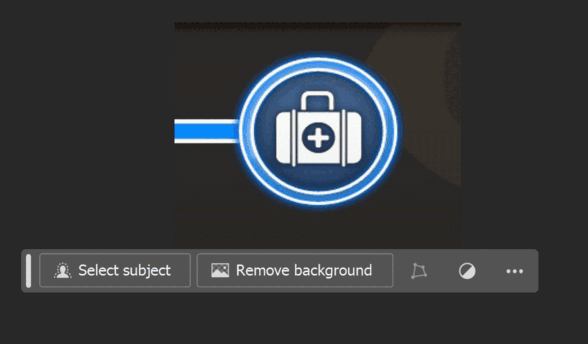

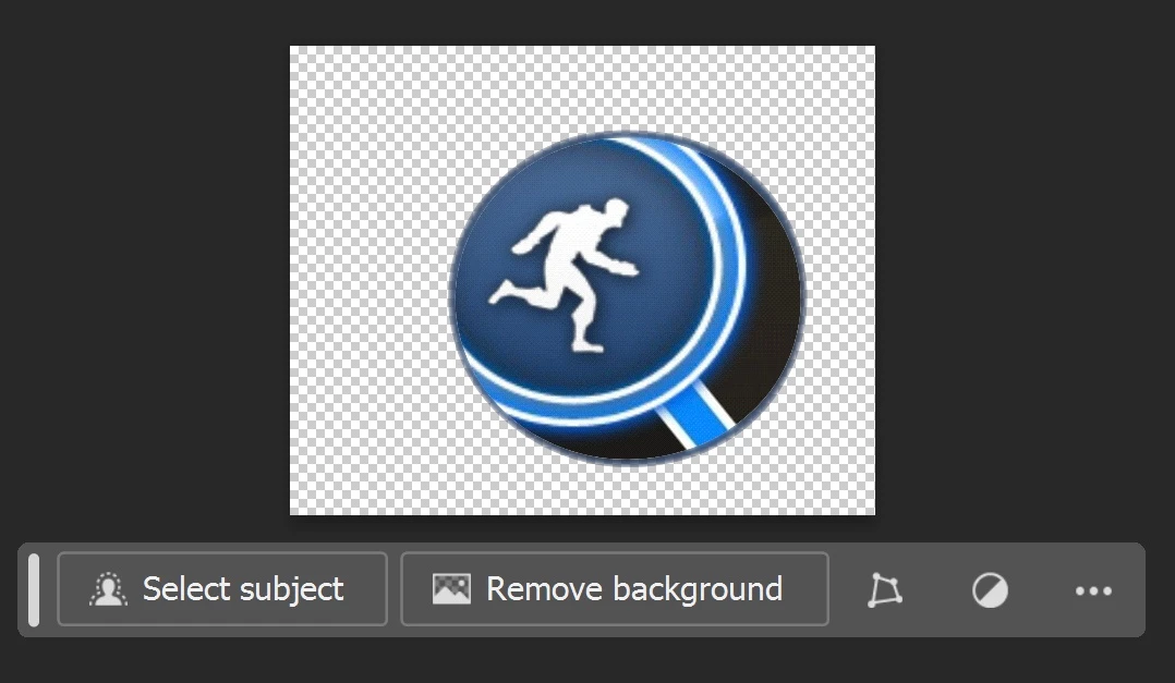

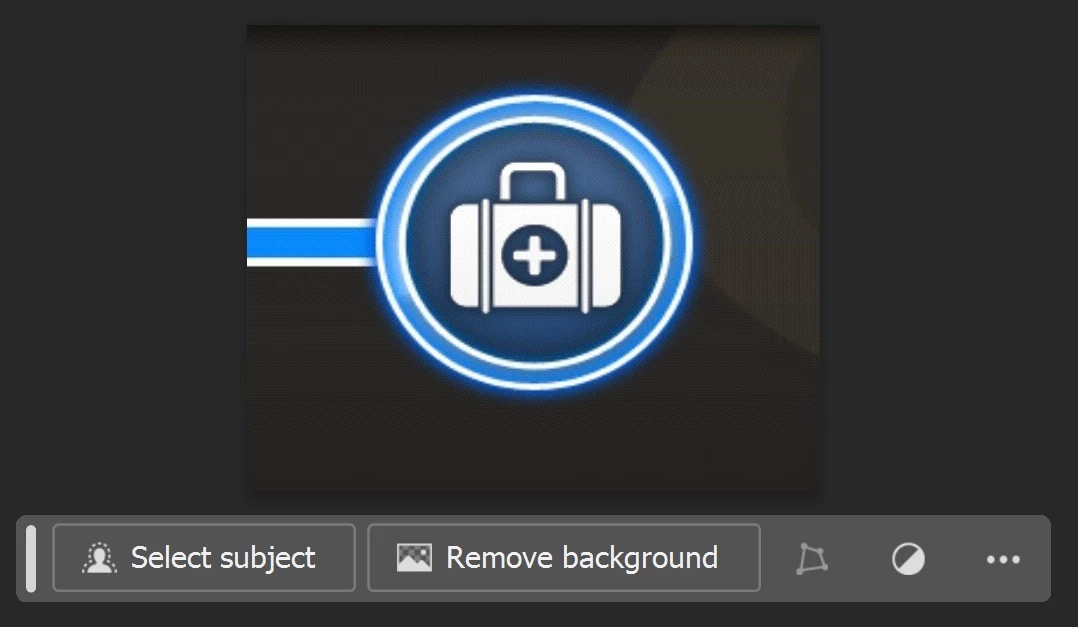

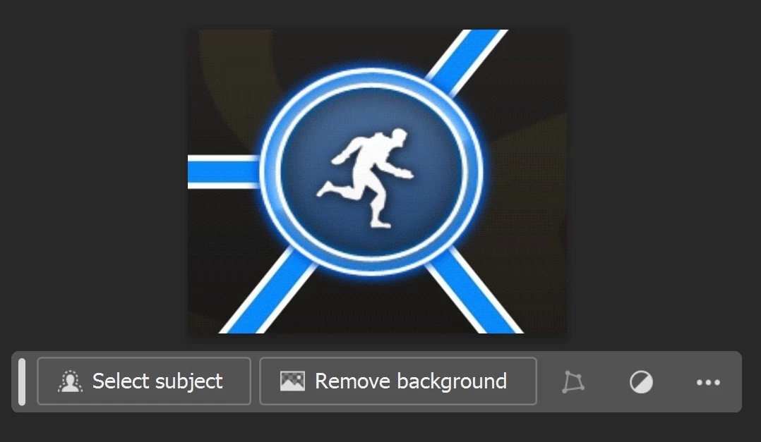

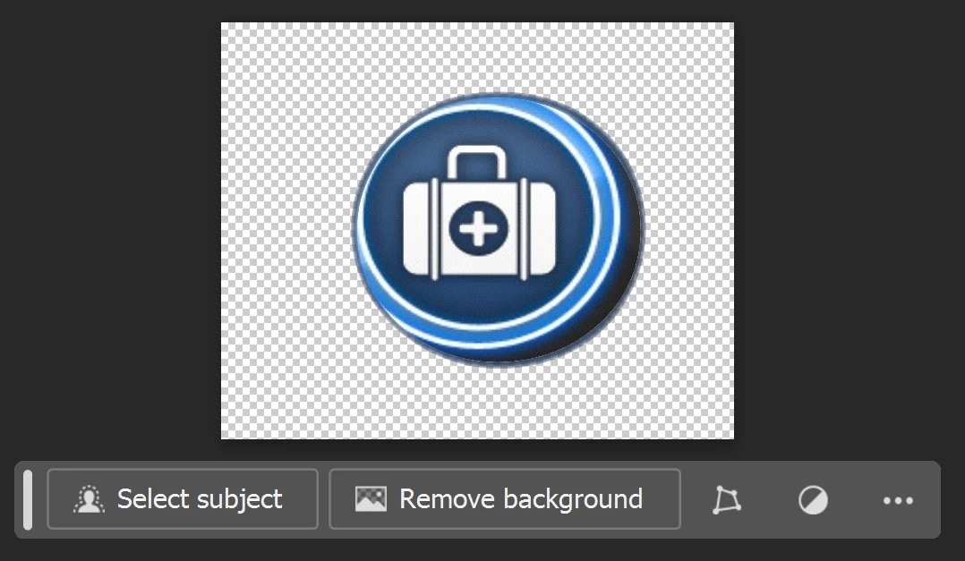

Would it be possible to take a batch of photos, all with differing dimensions, and using a tool, to "recaliberate" their center, so as to allow a given automation process to take place much more rapidly?
For this example, I'll use a few of the images in question:
While these icons may appear to "big" or to "small", they fit within the autmation process I've created just fine, the heart of the issue is just finding that "sweet spot" where the circle crops (the core of the auto') can indiscriminately remove the background.
Correct answer Stephen Marsh
I am not aware of any method to automate what you require. This can be partially automated via Select > Select Subject, however, it will still require manual edits. You would be better off just creating an action to select the oval shape which will be better than Select Subject. The selection can have the modal control active for manual interactive transform selection, then when committed the rest of the action can complete the task.

Please provide static/non-animated before and after examples of at least two icons (four in total).
LEFT4LAZY
LEFT4LAZYAuthor
March 4, 2024
You got it @Stephen Marsh:
Stephen Marsh
Stephen MarshCommunity ExpertCorrect answer
March 4, 2024
