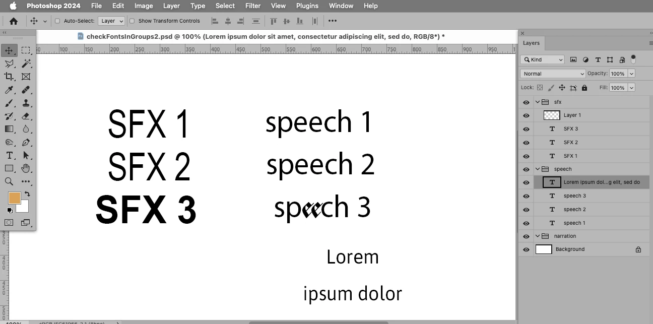

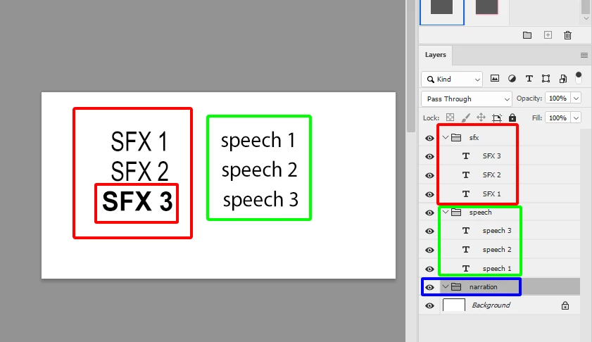

I need a script to check fonts for groups in a fixed file. Each group is assigned a different font, and when text with the wrong font is detected, a notification can be displayed. If the group does not exist or the group does not have text, it should be ignored.
I have attached a specific image below. Each group "speech", "narration", and "sfx" will have its own default font. For example:
  • sfx is Arial Narrow font
  • speech is Myriad Pro Regular font
  • narration is Arial Italic font
In the sample file I have attached, I have intentionally changed the text of "SFX3" to a different font. If the script can detect this, it should display a notification (e.g., "Incorrect font "SFX3")
Group "narration" in sample file have no text, then just ignore it.

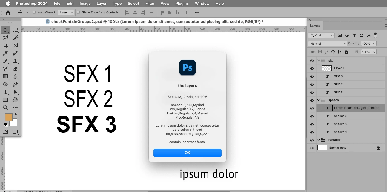

c.pfaffenbichler
April 3, 2024
I updated the posted Script, have you been able to test it yet?
KathyyyyAuthor
April 5, 2024
It's working really smooth! Thank you!
