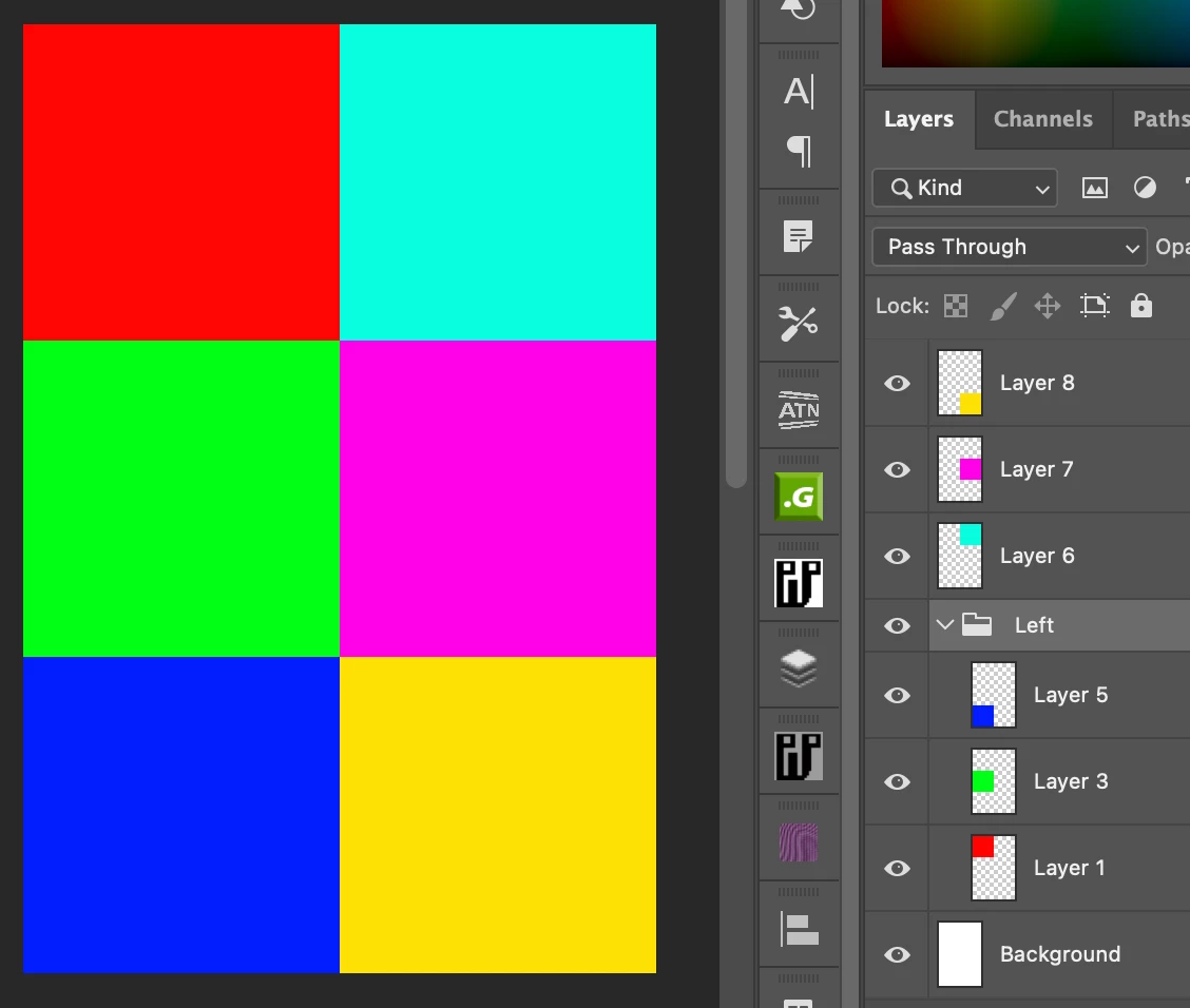

I have had success with an action, but there are limitations and conditions...

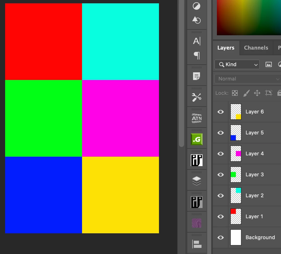

Starting with the following layer structure:
The action is rather long and complex:
It crops and deletes unused layers, then groups them for both the left and right halves, then combines the two back into a new single document:
This is just my first attempt, I'm sure that it can be refined... But I'm left wondering if it may just be better if you do this manually as you have been!
