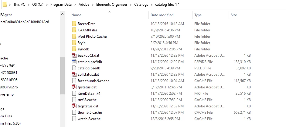

this is the file structure for my pse9 catalog file (now named "catalog files 1 1" as I have tried to convert twice)
I would guess the problem is PSE15 is looking at the catalog.psedb file dated 9/20/2013 instead of the file named catalog.pse9db dated 11/17/2020.  Should I move or rename catalog.psedb?

I have never seen two main databases files like this in the catalog folder and I have no idea why that has happened. However it appears that the folder contains the contents of two different catalogs folders with different dates and different versions.
For instance, catalog.psedb comes from a PSE6 catalog.
My suggestion:
Do a copy of this catalog somewhere else.
Delete all the files which are dated before 2020
Now, try the conversion after browsing to the new catalog copy.
