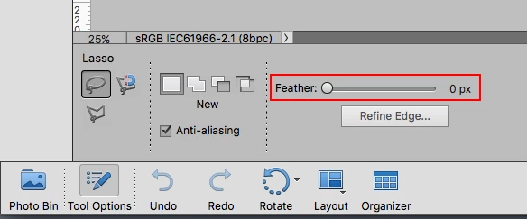

In the Lasso Tool options make sure there is no Feather set before using the Lasso Tool.
You want the Feather set to 0 px (zero)

THANK YOU! That worked. My scan cleaning up abilities are back where they
used to be.
